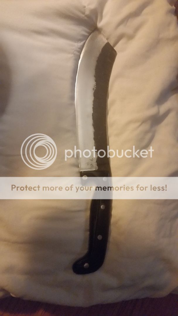

Part of my recent large order, a Farmcata by Anil. While the blade work is pure perfection, the handle details were not up to snuff with my likes. Yes, I know I'm a perfectionist and the Kami's don't have that amount of time at their leisure. This is simply a Farmcata untouched besides about six hours on the horn handle. It's perfectly tapered for my grip, fit, finished and perfectly to my liking.

Very nice. Did you have to reshape the horn, or just polish it up? If you reshaped it, I'm curious what tools you used. I figure files + sandpaper would work, but I've never actually tried it with horn.

Slightly rehaped. Horn is so very easy to work. Flat, tapered and round needle files. 400-1500 grit paper, Semichrome, white rouge and then some good wax, Renaissance in my case. Sounds way more intensive than it is. Easier than working with most woods, far more forgivable.
