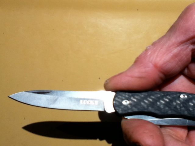

I have a whole thing to post here on general impressions. This is roughly a copy of the review I left at the vendor. I didn't leave them any photos so you see how "Lucky" you all are. I just got it a few hours ago so . . . anyway
Well . . . hmmmmm
Well it's a knife. Don't believe everything you read from the supplier. Don't be a picky knife connoisseur and you'll do fine.

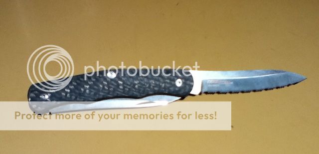

Hey the handles DO look surprisingly good in these photos don't they !

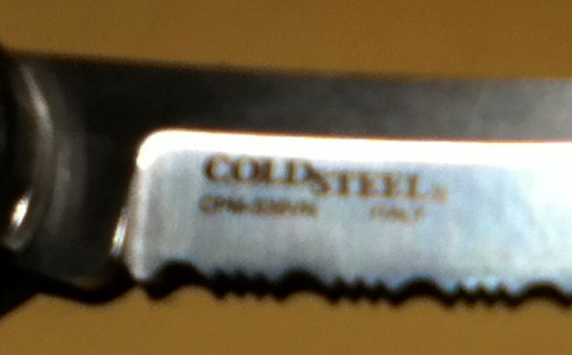

It's an OK knife. What kind of chaps me is what I got is not what is advertised at the online store spec wise. I ordered a Lucky that is described as having the new American made CTS-XHP crucible steel. I have two other Cold Steel knives with that steel and that is what I like and wanted. What I got was the CPM-S35VN which if heat treated correctly can be pretty darned good . . . but THAT IS NOT WHAT WAS ADVERTISED THERE. The blade is very clearly etched CPM-S35VN so there is no question about it. By the way it is also etched ITALY for the country of origin.
SECONDLY the blade thickness is spec'd at 1.5 mm, that is what it says it is on the Cold Steel Web site as well. What I got are two blades that are a tad over 2 mm thick checked with a Mitutoyo metric dial caliper. I am a thin bladed knife fancier so I am less than impressed.
Over all both blades are sharp; the regular edge blade is rough ground but is shave sharp. The finish on the blades are consistent and nice enough. They are a ground finish with coarser lines on the bevel and smoother opposed ground finish on the flat area. A nice touch would have been polished on the flats and the same grind on the bevels but . . . OK. The finish is growing on me.
The carbon fiber is not what I am used to seeing in sports equipment which is usually highly polished and like clear finish, epoxy, with fiber under the polished finish. These knife scales are kind of like cold paper to the touch (as opposed to glassy) and without clear finish (the epoxy is down in the fibers). That gives a bit of texture and grip to the scales so that isn't bad and kind of interesting. I was going to say " but it isn't as lovely as I would expect a gentleman's dress knife to be" I am changing that . . . it is swirly and reflective and pretty interesting to look at. Just don't expect a high gloss / void free / under glass finish. Still it isn't a bad thing grip wise and there were very few voids and they were quite small so the scales are pretty good.
I am not sending it back; I didn't pay MSRP of $124. If I had this might be already taped up with the return label on it.

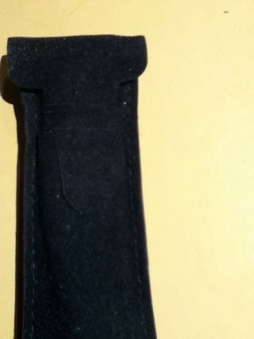

PS : it comes with a little pocket slip to keep the other things in your pocket from scratching up the knife. The tab flap to hold it closed was an after thought and is so frustrating to get tucked in just expect to cut it off with a pair of scissors the same day you get it. WHAT THEY WERE THINKING I DON'T KNOW. I do know the person who designed the slip had never once used it other wise they would have redesigned it. And it could have been made as a simple pocket slip and saved money. As it is it is just an embarrassment for Cold Steel.

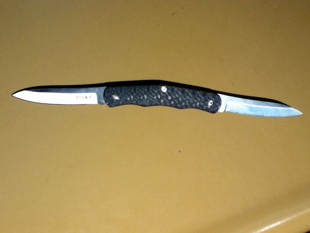

PPS : one other thing I noticed . . . the scallops on the handle; where you might imagine your fingers going to grip the handle . . . well they are only functional if BOTH blades are open. Like I said . . . hmmmmmm
When one blade is closed it feels like it could be pretty easy to slip off the back of the folded blade and onto the open blade. Kind of defeating the use of such a thick stout blade. Maybe a little jimpping out on the curve of the nose of the back of the blades so when closed you get some traction from it ? ? ? I don't know.

the slip is absolutely useless and should just be thrown in the trash. Last night with the lights dim, before bed, I tried to slip it back into the slip and it wouldn't go and wouldn't go and finally I put it in the drawer just balled up. This morning when I looked the knife was trying to come out the side of the slip through one of the slits made to create the strap to tuck the tab into.
If one tried to cut off enough of the slip to eliminate these slits the slip would be too short and also the stitching would unravel. A small niggly thing to harp on but . . .
The knife is fun to have in one's hand and interesting. Not the best fruit slicer. Probably be good as my portable steak knife since I'm a poor man and will never see the thick ones. When one has the knife in one's hand especially with both blades open one has two almost simultaneous urges :
1. Baton sixty penny nails in two with it (just because it COULD and it would be fun).
2. With both blades open fight off a landing party of Vikings slashing alternately back and forth first with the serrated blade and then the plain blade. (keep that in mind when you look at those finger grooves).

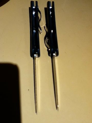

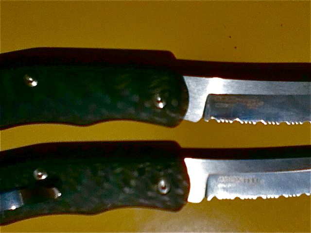

Hey Ceptor781,
Does your CTS-XHP have nice dinged flat spots on the edge from the factory ? :eek:
I ordered one from the vendor you used and sure enough I got the CTS-XHP. Now I have one of each.

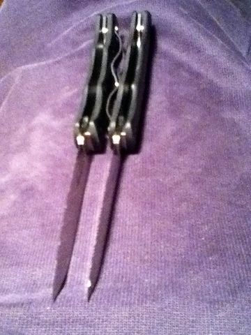

EXCEPT this latest one seems to be a second that the factory sent out anyway. BOTH blades contact the plates that make up the spacer/spring and flatten the edge in an area about two or three mm long. See the light reflecting on the one open knife in the two photos edge on. My first knife, with the S35VN, has tons of clearance (on the order of two or three mm) between the same springs and the edges.
Is it really so hard to make pocket knives ? Case and Victorinox seem to be able to keep it together.
It should be interesting filling in some "stuff" where too much steel has been removed from the stop thus causing this collision.
Note I have removed the plane blades from both knives ; and no I didn't cause the damage to the blades, I noticed the dings before I ever started my monkey business.
Again; I am going single blade on each knife so I can make use of the finger grooves and because the knife feels a little awkward with the folded blade in the way even if it didn't have finger grooves to uncover.
I had already decided before I noticed this little disaster that I was going to use the CTS-XHP serrated for my steak knife/ to be used on ceramic plates etc. and reserve the S35VN for my keep it sharp serrated for use on rope, clothing, emergency seat belt cutting etc. . . .

I would have liked to have been the one that dulled the points and edge at the front of the blade. I am pretty darned sure it would have NEVER gotten this flattened from use on a plate.
