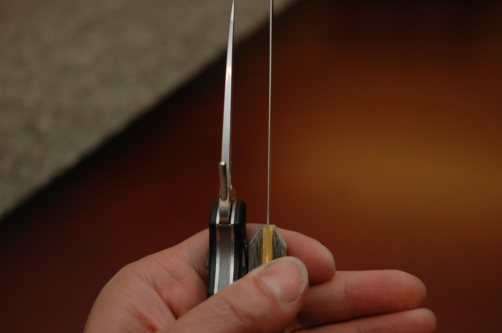

This one is 10 3/4" OAL with a 6 1/4" Blade. S35vn full convex grind with zero convex edge. Thickest part of the convex is .038 which is less than 1mm :eek: Handles are olive linen with yellow liners. It can easily whittle hair and goes through hard potatoes like butter.

Next to a Spyderco Pikal folder for spine thickness comparison ;)

Dude, that blade is even thinner than the liners!
It should be flexible at that thickness, maybe a filet knife version is next?
