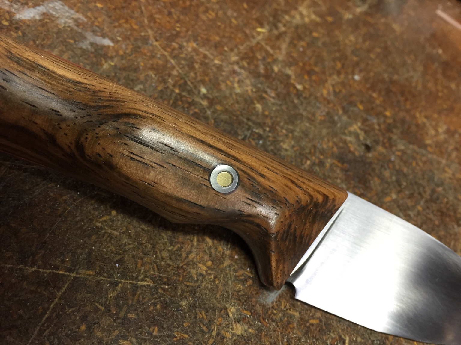

Ok thanks people. I was kinda stuck on the bulls-eye look but live and learn. Here is the knife as it looks now, just some more guard work and polishing.

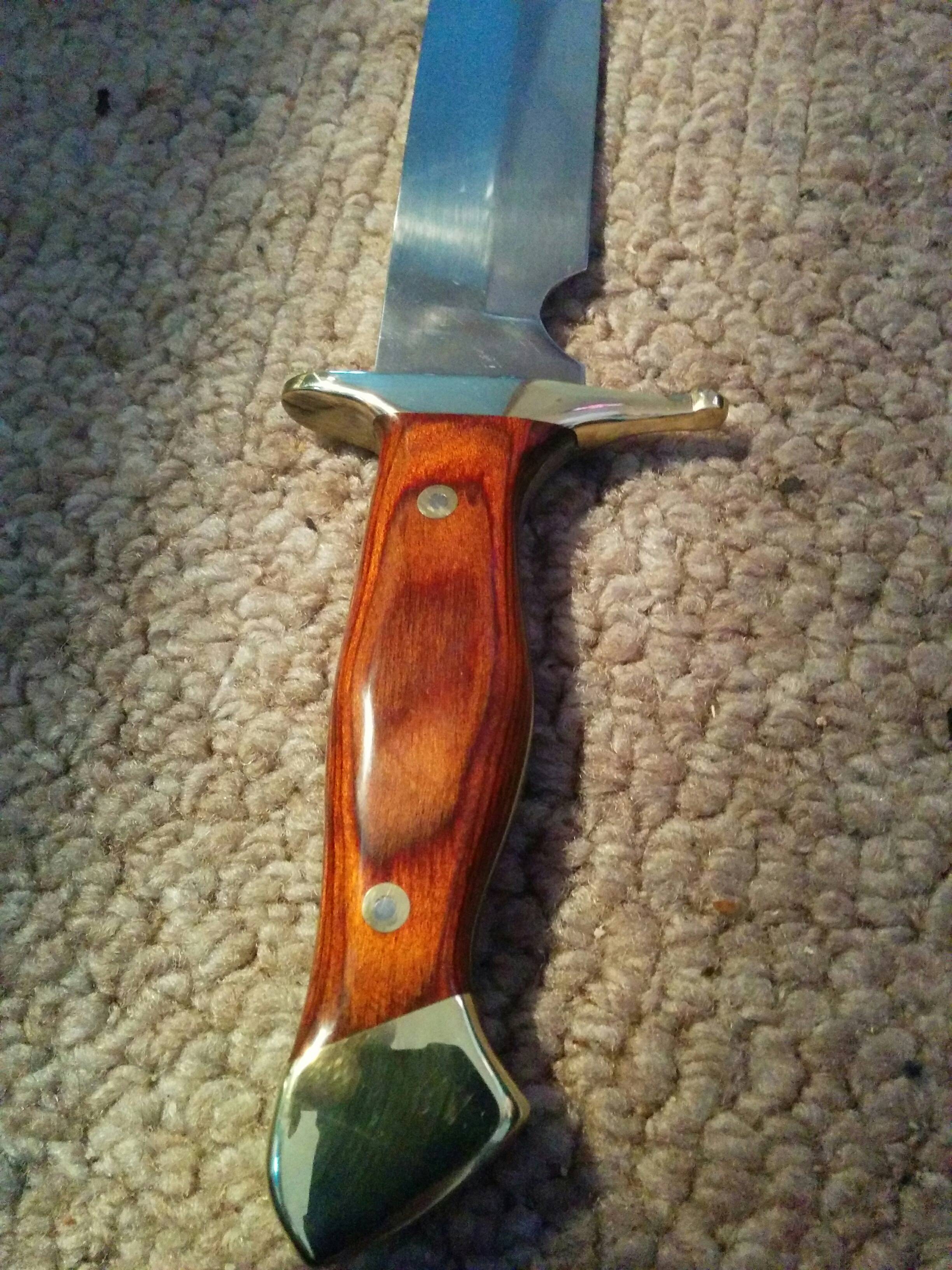

Just finished up my 1st knife, I used loveless on it, got the smiley too.
Nice knife BTW

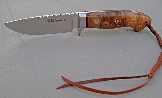

This is one of my most recently completed knives, . . . and it included loveless style bolts.
