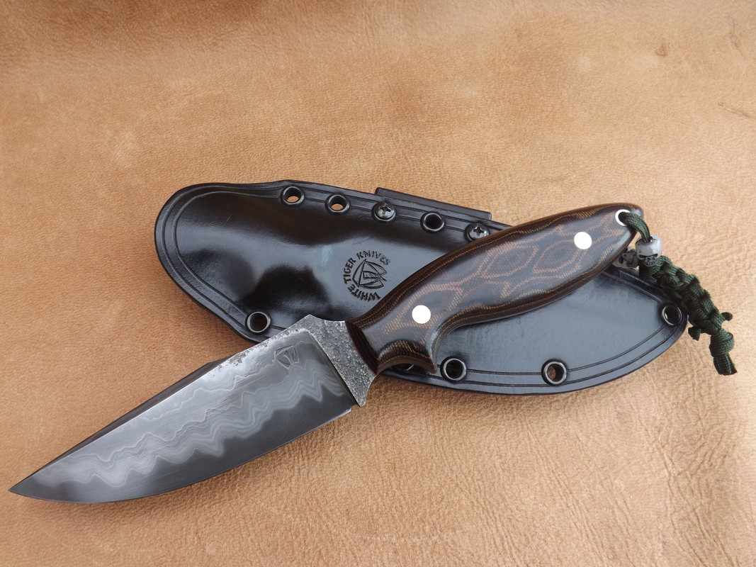

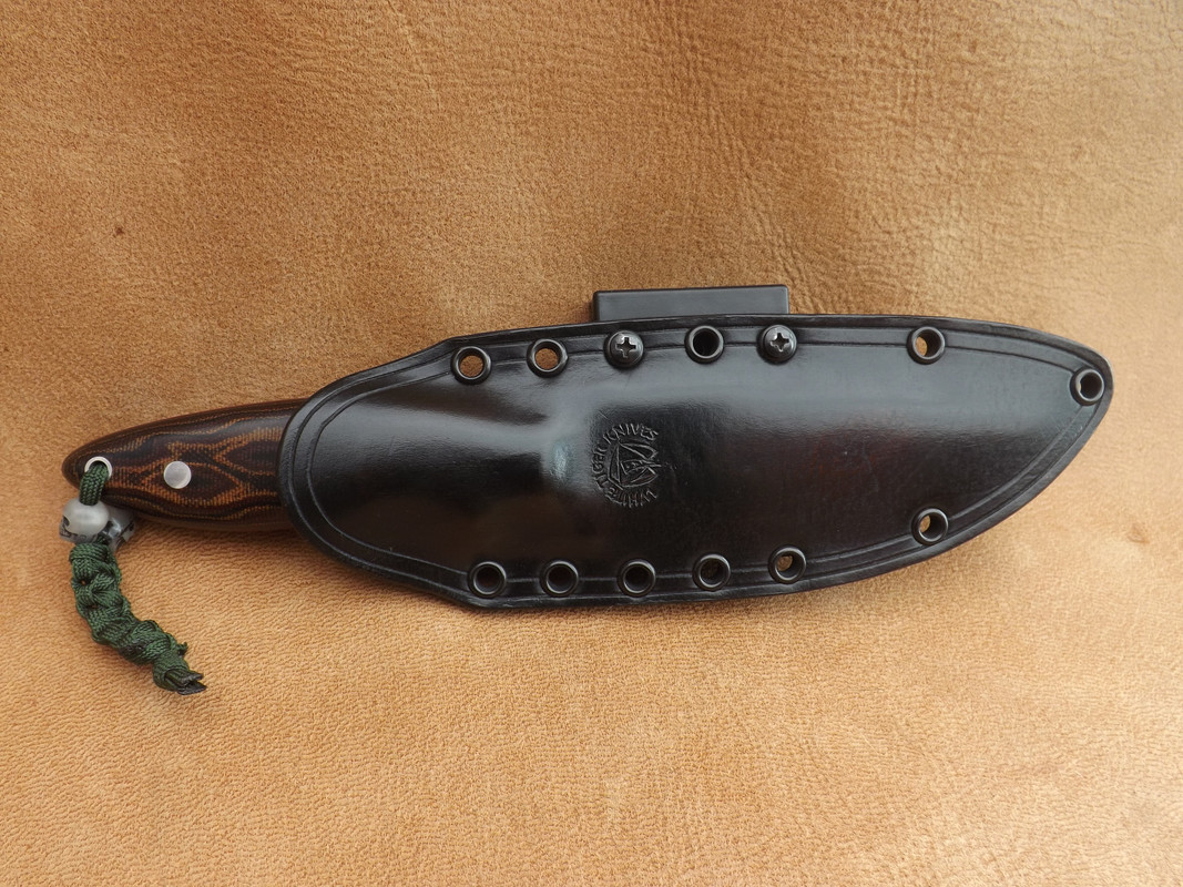

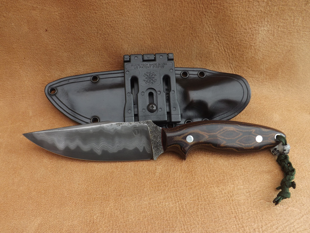

Hi Guys
Just wrapping up some loose ends before the UK Knife show on Sunday. This harpoon point hunter has a laminated blade with an L3, (52100) core and Suminagashi 2 cheeks, blade length is 130mm, blade thickness is 5.5mm and the overall length of the knife is 250mm. The handle scales are python skin Micarta with red liners held with two stainless Corby bolts. The sheath is a wet moulded leather pancake style dyed black with Kydex rivets and a Tek-Lok belt clip.
Thank you for taking the time to look, all comments and critique as always very welcome.
