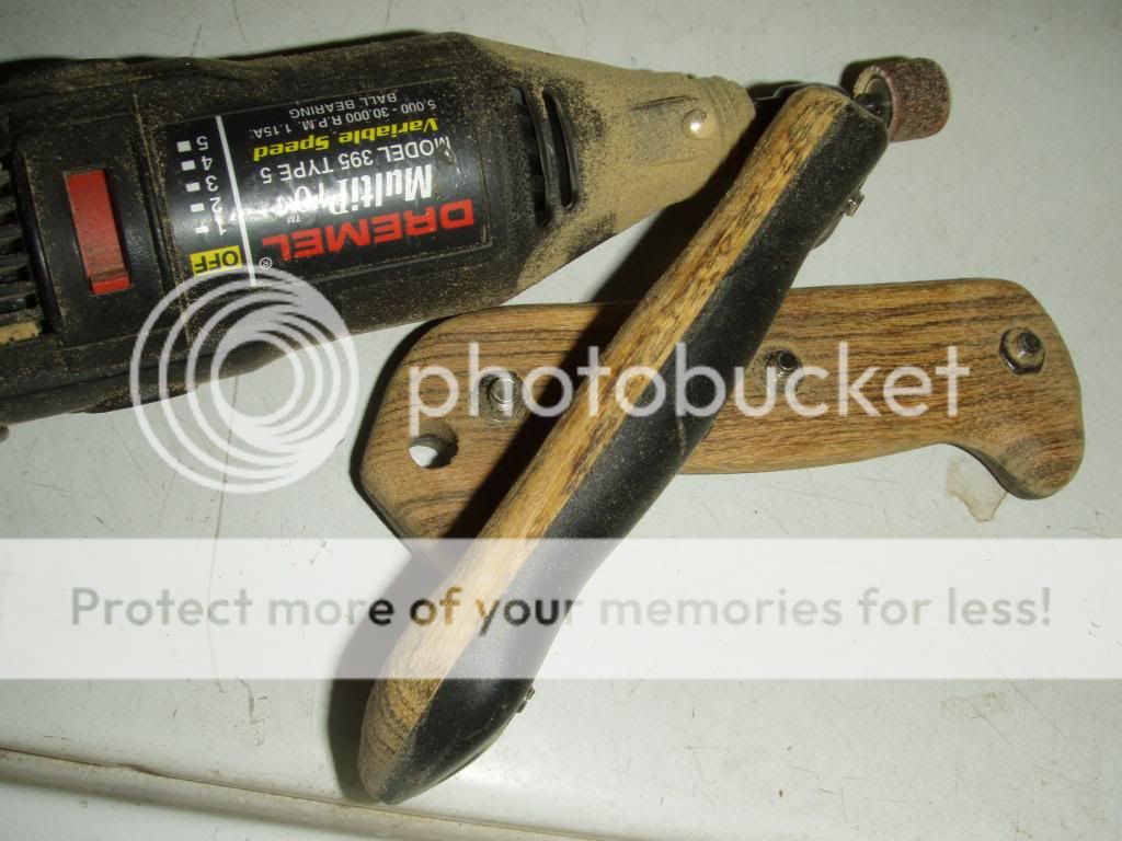

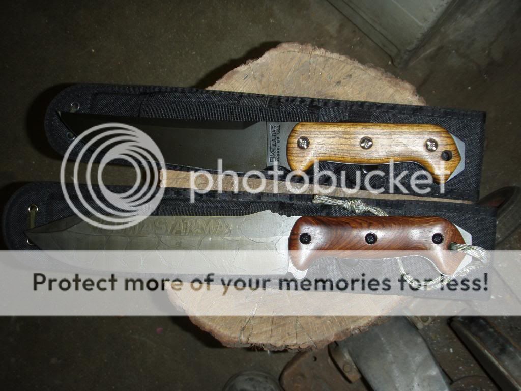

I picked up my first set of wood scales from Tommy the Who. They are Honduras Rosewood, and I am trying them on for size on the Magnum Camp knife.
They give me something to shoot for.

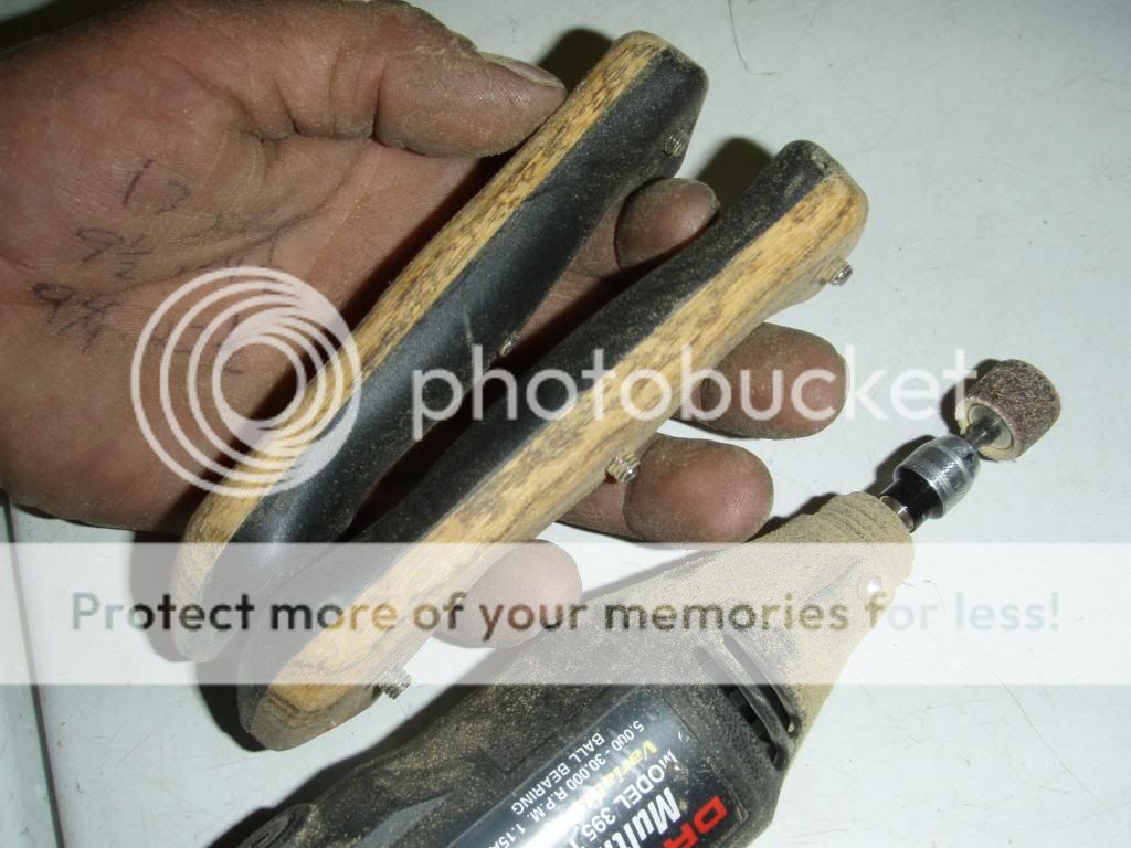

But I have some Bocote blanks to finish which started out on the thin side for Becker scales, but I will work with them. I cut corners off with a power saw, then roughed in with a 4.5" angle grinder fitted with a sanding disc. Finally I finished the fit-up with the old Dremel. Now it's all hand sanding & final finish. Even though they were a bit thin, they will suffice. I am pretty easy to please when I just start out a new type of project like these. Besides, wood scales grow on trees! :D I can try again if it don't come out perfect.

If they're too thin, it's easy enough to shape some liners and drop 'em underneath. People have used CD cases, plastic binders, or kydex. I prefer G10, but it isn't usually just lying around - and doesn't grow on trees! If it's thin enough and flat, you could even use a strip of wood.

I move for a full broadside picture of those scales on that BK-5.
