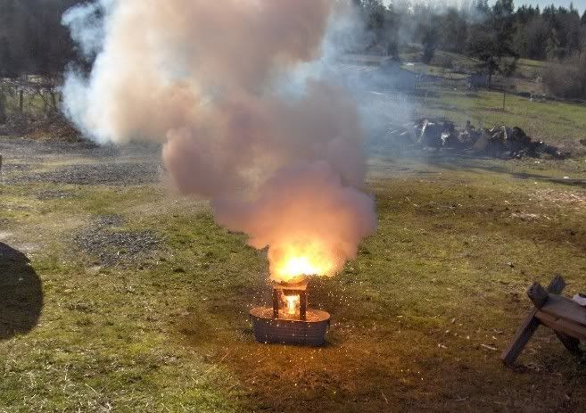

If you use a primary combustion crucible and use a mold for the catchment you could cast some simple shapes but you will also get alot of slag in the mold. On all the charges I have done up to 50% of the secondary catchment is slag. The slag seperates and solidifies on the top of the button.
You can see the liquid iron running out of the primary combustion crubible after the the steel tap has melted.

I use a SiC catchment crucible that is pre-heated to reduce the shock of it going from ambient air temp to 3000 deg. Pre-heating also allows for a slower cooling which will purify the iron/steel a little better. It's also imbedded in vermiculate to insluate it and thus slow the cooling down even more.
Thermite is fun and interesting to play with but there is no consistancy in the end product. You could get a near pure iron button or something close to cast iron. And that is while using the same mix ratio.
There are several little tips/tricks to using it for steel/iron production.
