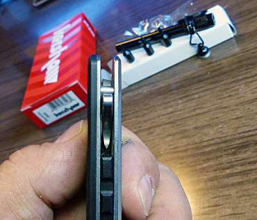

While in the warranty dept. I noticed that, for LEFTIES who carry with the clip thru the black G-10, the clip screws are too short to reach the steel and that the screws only grab onto the G-10 and can come loose (note how thin the steel liner is under the G-10 vs the steel on the lock side of the handle). Solution here is slightly longer screws. Sorry if this has already been mentioned lefties.

Now we come to the replacement screws. I didn't mention this before because I didn't think it was relevant but I will now. Since I didn't receive a reply from my initial email, I called KAI 2 days later, spoke to customer service, and explained the issue. They were aware of the problem, said they'd found screws from another model that work fine, and said they'd send out the fix promptly. I received that replacement kit today, so now I have 2. Each package contains 2 screws and a pocket clip and everything was in black which is great since they will match the G-10 side. The problem is that the screws are the same length as the originals and therefore don't do anything to resolve the problem.

I got my replacement screws in the mail today. They sent me two of the original ones AND two that are a bit longer. The new screws work though one barely threads in to the steal liner. So I guess this turned out okay. Their communication could have been better (or even existed). They never replied to my email to let me know they were sending the screws out.

Yup, I got my replacement screws yesterday. 3rd time was the charm and I got the same set as you, craytab; 2 short and 2 long screws in a polished finish. Too bad, the two sets of black ones I got that were too short looked a lot better with the black clips ;)
Both of my long replacements bit fine but from what you said about one of yours not biting, it sounds like the G10 may be thicker than it should be. It's clear there are some serious QC issues with these knives. I have more than a handful of inexpensive (say, $60-ish or less) Kershaws and the Thermite is by far the worst fit and finish of the bunch. In fact, I've never had cause to complain about any of the others.
