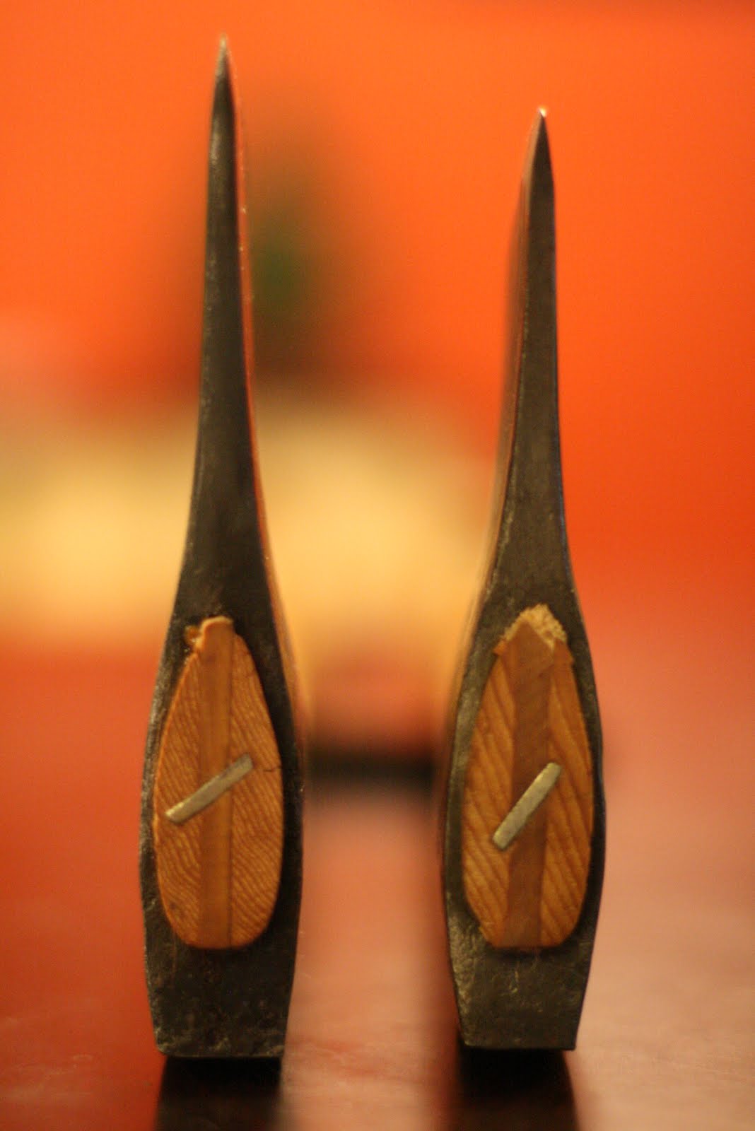

In lieu of anything actually useful, I want to at least make myself clear on the topic.
These are Maine made axes, sometimes relegated to the roll of splitting because they are "thick". These are what I would call "thin" (the left one especially).

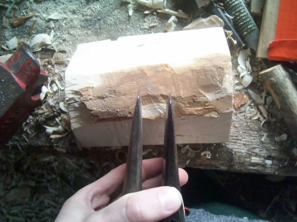

These are later True Temper kelly boys axes. These were never taken down from the factory and are thus what I would call "thick". The camera couldn't zoom enough to illustrate it greatly, but the one on the right is a good example.
Thickness or thinness is pretty much contingent upon the first 4-5MM most importantly, and the marriage between that zone and the subsequent 1/2" to 1 1/2". Most axes can be made thick or thin in a matter of 20 or 30 minutes with a file.
Sweet. I'll have to post a profile shot of my Keech as well.
Those look like good choppers to me!!!
Racing axes are a good example of a thin-to-thick taper that makes a good chopper.
I was explaining the other day how chopping is more splitting than severing fibers. You need initial cutting penetration but then wedging to pop the fibers apart. A thin axe delivers good penetration (sometimes) but does not pop the fibers as well. More penetration does not bode while for cleanly chipping out the cut. The deeper the bit goes the more it loses its pep to pop the chip. one that flares out further up the cheek prevents binding, pops a better chip via regulating depth of cut, and is easier to learn to use in some instances.
