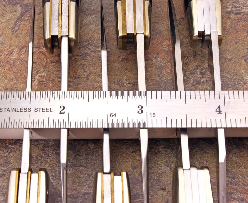

Here's a photo of 301 blades across time. 1966 to 2008. Hard to tell differences. Early contract knives were likely 440A steel.
Left to right.
Knife 1: Schrade made 301 1966-67
Knife 2: Camillus made 301, scale rivets, MIUSA on tang 1971
Knife 3: Camillus made 301, Buck,301,USA on tang 1974 to 1985
Knife 4: Buck made 301, 425m steel, Buck Escutcheon, dated 301V, 1989
Knife 5: Buck made 301, 420HC steel, dated 301U, 1998
Knife 6: Buck made 301, 420HC steel, Dymondwood, dated 301 uparrow symbol 2008
Excellent photos 412(or are we now back to 300:p)
Knives 2, 4 and 6 seem thicker than 1,3 and 5... at least by my questionable eyesight. Thanks:thumbup:

Actually with my Brown and Sharpe Mfg. Micrometer, measured just in front of the tang along the spine, they are:
1. Schrade 66-67 .076
2 Camillus 71 .086
3. Camillus 74 - 85 .078
4. Buck 89 .096
5. Buck 98 .088
6. Buck 08 .086
So Trax was correct twice. Fritz only missed it by .001. It must have been the lighting. 300bucks
