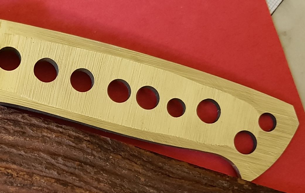

Another thing that works well for recessing the tang is the corner of a small diameter wheel on the grinder. Because I can be anal about some things, on my full tang knives, I swiss cheese the tang AND recess both the tang and the scales, And use corby bolts. As they say, better to have it and not need it than not have it and need it....

Just be careful and make sure you keep each sides depression less than .035" deep. The purpose of doing this is merely to allow the epoxy to squish throughout the whole tang, making one big thing of epoxy holding the scales together instead of multiple little holes holding the scales together.
You can also buy a very fine filler from West Systems which prevents you from squeezing all the epoxy out of the joint. The filler acts like a very thin layer of marbles which holds the tang and scale apart with all the gaps filled with epoxy. It will give you a glue joint which is perhaps .001" thick - too thin to see.
