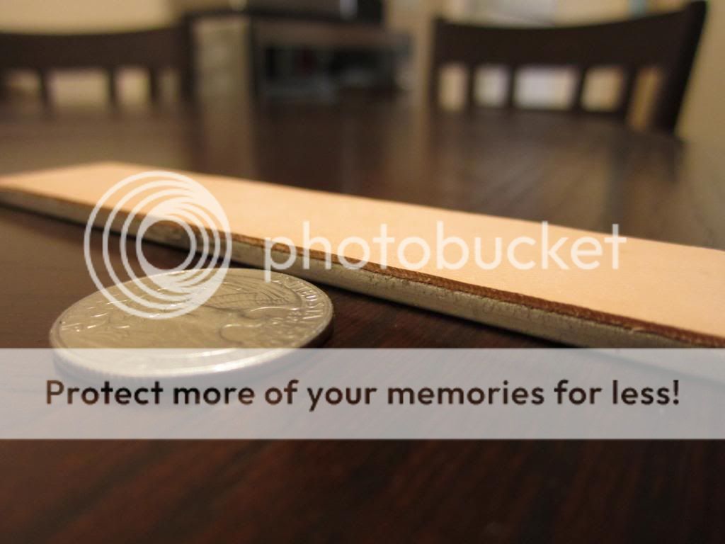

Does anyone know of a good (hopefully not too expensive) thin leather i can use for a strop? I have heard that kangaroo leather is thin but ohh man is it expensive!
Roo leather comes thin , and can be stretched over a hard backing to make it even thinner. I use most of mine on the smooth side.

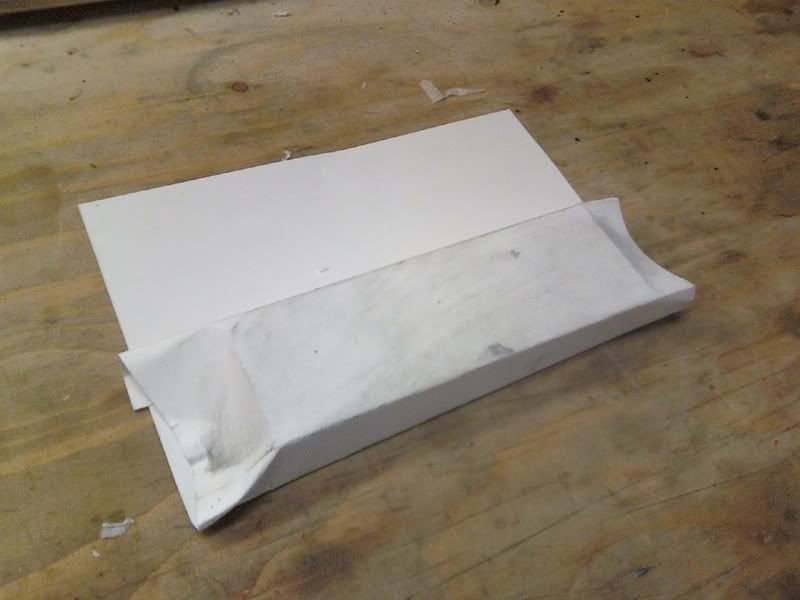

You could always try a sheet of paper first, works better than you might think. Just wrap it around your benchstone.
^^Sort of amazing, what simple paper can do when used on a firm backing. Used with compound, all you really need is a substrate that'll hold the compound fairly well.
