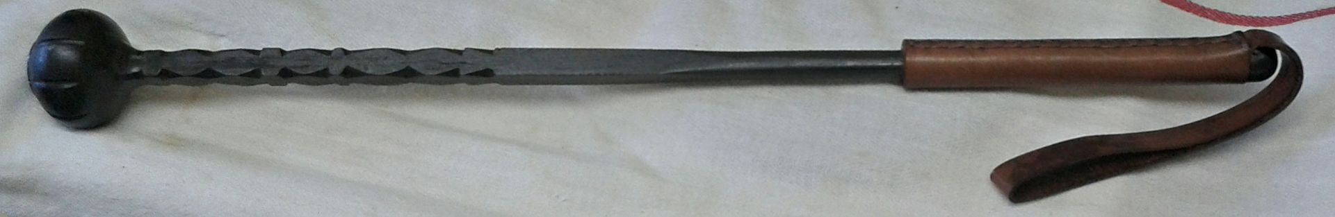

on a different note, pommygrenades aside, tannic acid will turn red rust into a nice black oxide form that will protect the blade from further red rust attack, it's essentially the black you get from forging villagers. it does not attack bare steel, so to blacken, you must first let the blade rust all over. tea doesn't have strong enough tannins, so a commercial grade of tannic acid must be used. you can buy tannic based rust treatments premixed, i got a litre on ebay, will last me for years. brush it on, let it dry 24hrs, dampen it with water again, wait 24 hrs again, wash & dry. oil.
here's one i prepared earlier. was delivered by PO covered in a fine coat of new red rust. musta been a leaky PO van.
did NOT clean off the red rust before tanning it.
p.s. = the head of that mace do look a bit like a pommy granite. :)
Lol. Thanks for rubbing it in even more. Pommy Granite. :-p
The pictures look cool. Gotta order some tannic acid. It's probably interesting on leather and wood as well.

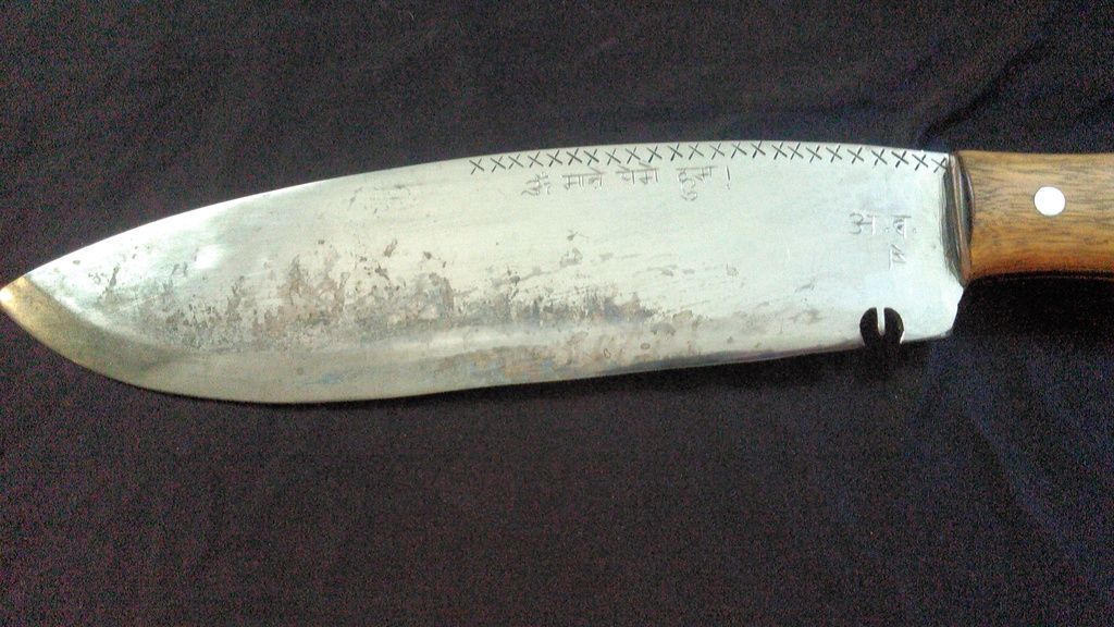

Using carbon knives in the kitchen I found a substance even more potent than bum grenade juice. It's Papaya. A really deep black where it covers the metal and a light halo in the periphery probably due to oxygen reacting there too.

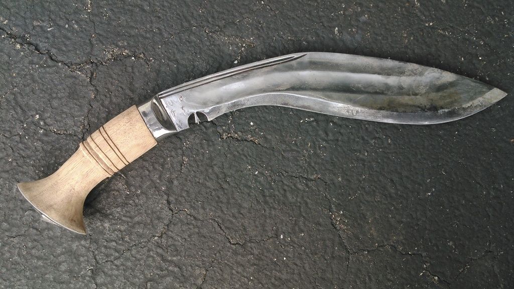

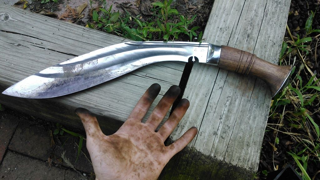

Can't say I recommend it cuz it turns hands and everything else black too, but I cut up some fresh black walnuts with a new Dui Chirra and clean KLVUK and it left some sweet patina.
This is right after
This is after some 0000 steel wool on the blade and sanding the handle
