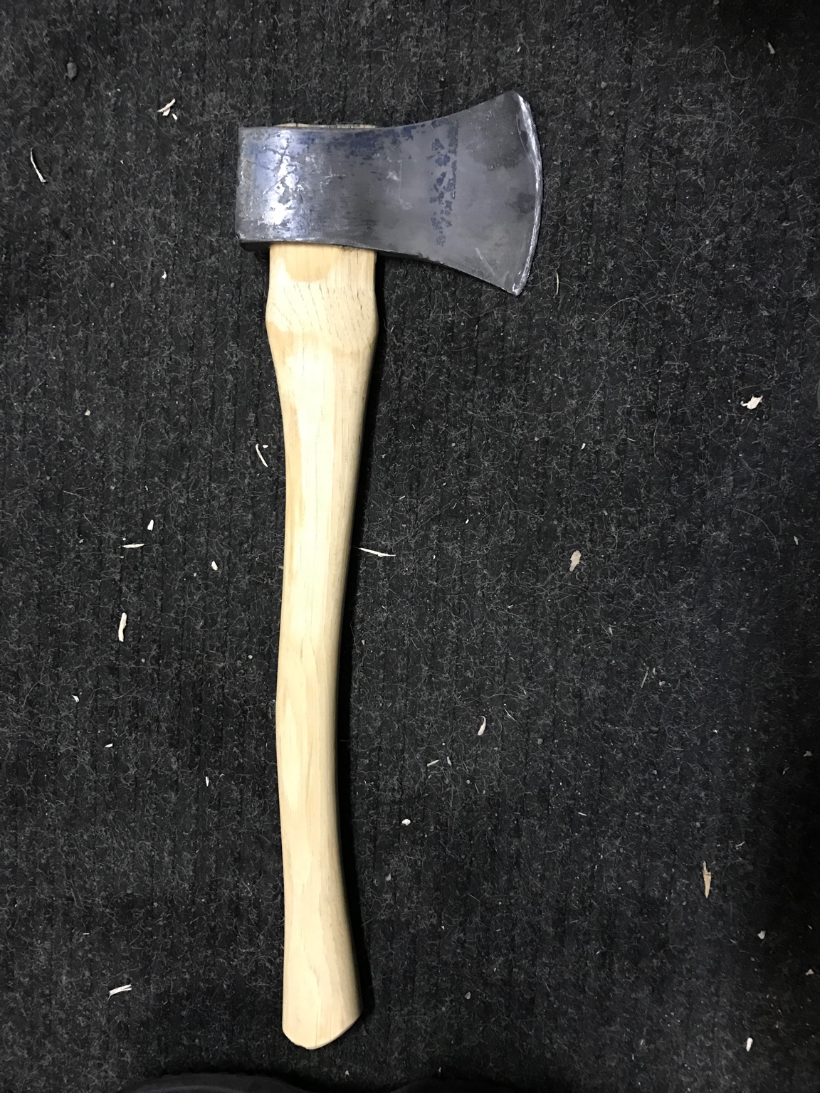

Pretty sure I goofed and hung this baby upside down! This a Welland Vale i rescued from in laws farm. This is the start:
And here it is now. But I'm pretty sure I hung it upside down. Put it on a 21 inch handle, perfect for size and weight.
To me, it looks correct. I am ignorant in how to determine this but looking at the toe of the head it is more rounded then the heel of the head. Making me think it got struck more and therefor worn down more. This is just my ignorant observation though.
Sent from my iPad using Tapatalk
The manufacturer's stamp on the vast majority of axes is on the port side, (the left) of a head. Judging by the pictures, your head looks to be symmetrical front to back so this niggly detail won't make any difference. But, were the eye to have a built-in taper, and then have been hung backwards, whether you like it or not you'll quickly find out if you goofed. Otherwise get out there and enjoy your 65 +/- year old piece of southern Ontario manufacturing history.

You can and should take the head off and put it on the right way.
The head should be down snug against the shoulder of the handle (the part of the handle where it gets much fatter..it should be at least a good inch or so lower down the handle than you have it set now.
It should sit down against the shoulder of the handle, and you would cut the top inch or so off that's sticking up and cut the kerf (the slot which the wedge goes in) deeper if need be. There is lots of rasping involved with hanging it properly.
isn't that thing meant to be symmetrical? if it's just an issue of hanging at the same end as the original handle, it might not be a big deal (or is it?)
That is what I was thinking, whether it is upside down or not(I can't tell) it needs to be rehung so it it sits on the shoulder.
The eye of the axe should be tapered. The smaller end goes on first so when you wedge the handle it expands and cannot let the head slip off.
