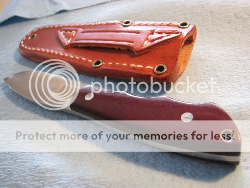

However, if you go with the mini-Canadian, know that its grind lends itself to a superior level of sharpness. The mini-Canadian is the sharpest knife in my collection, consistently so....and by a very noticeable margin. Very sharp you can get these little blades.....
Seen here at the bottom:
Here is my daughter's new one (late 2008) in maroon linen:
