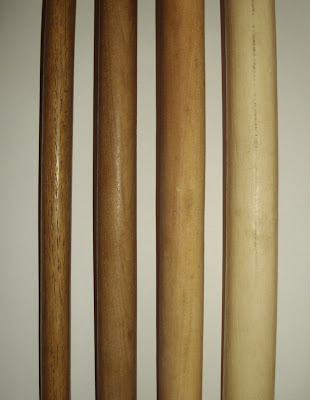

Some background on how today's axe handles have "devolved" to be much thicker than the slim and limber handles that old-timers preferred:
...The photo below is meant to demonstrate the devolution. It is, in fact, a brief documentation of history, because what you see here are commercially-produced ax handles, purchased in Canada between 1975 and 2011. All of them are hickory...
Here (from left to right) are their respective dimensions and weights of the heads they came with:
1. (1975) – 18x32mm, 31 inch long, head 3 ½ lb (my very first ax)
2. (1995) – 23x37mm, 27 inch long, head 2 ¾ lb
3. (2010) – 26x 39mm, 26 inch long, head 2 lb
4. (2011) – 29x40mm, 27 inch long, head 2 ½ lb
http://www.bladeforums.com/forums/showthread.php/820720-Introduction-and-quot-The-Devolution-of-Ax-Handles-quot

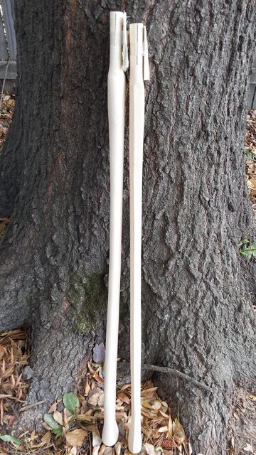

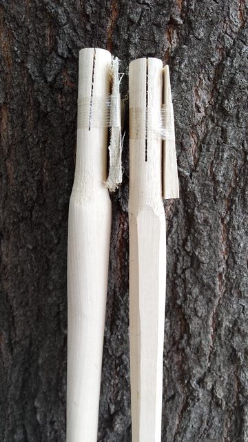

Another good option is order an octagon handle from House.
They are a bit thinner than the standard handle. Here's a pair to show the difference.

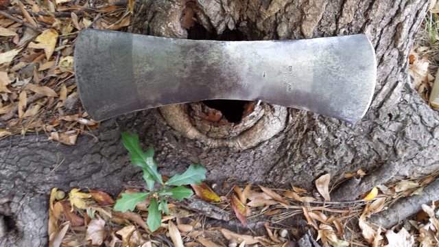

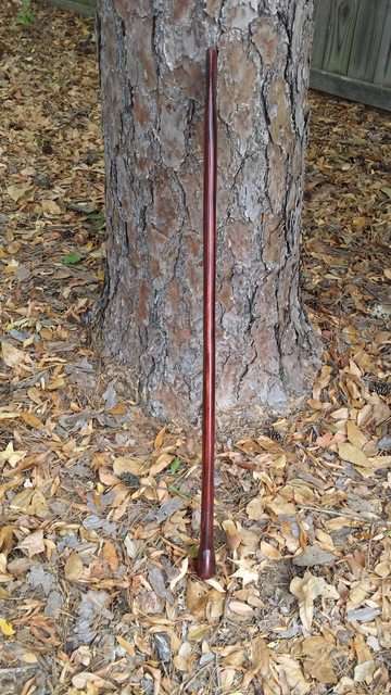

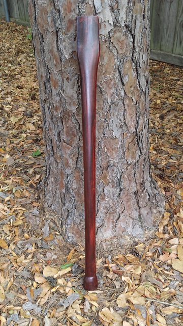

here's a House double bit that I thinned. Started with a rasp to hog off wood fast. Then a cabinet scraper and finished up with sandpaper. I'm not done with the stain yet. Will finish it up Saturday and hang.
That handle looks Plumb good!:)
Haha, wish I could say I had a Plumb to hang on it. This old Sager will look good on it.
