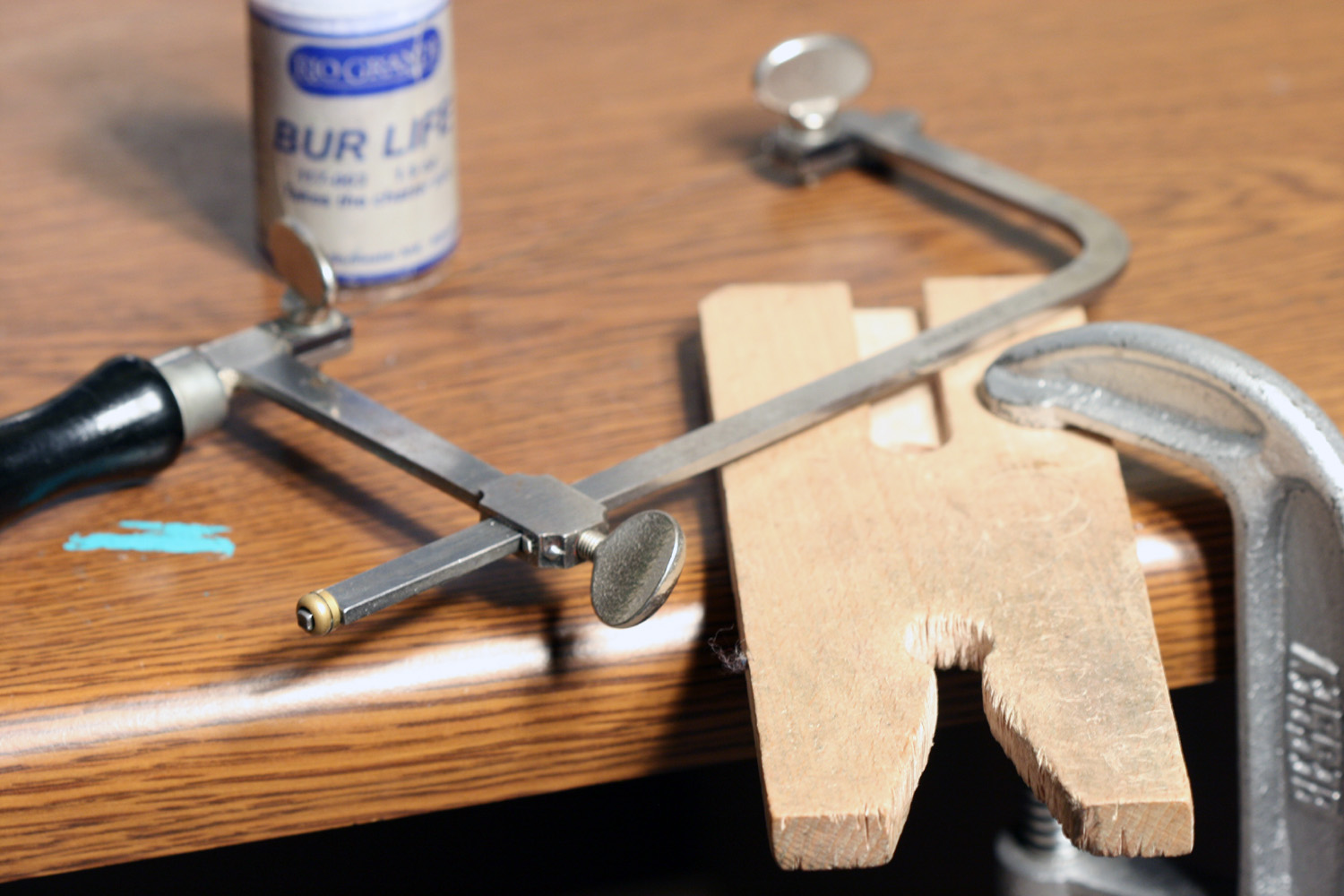

I think I would saw it on a table jig saw or use a coping saw over a jeweler's sawing fork .

I am cutting 7-inch rounds from the actual cardboard tube. The tubes are as large as 16" diameter from the store; after splicing, one is 26" diameter. Each is capped top and bottom with 30 ply chipboard, also 0.10" thick. The glue is hot-melt. The geometry almost requires a hand-held non-power tool for initial cutting (except the flat chipboard for which I used a portable jigsaw) and final trimming. A knife is safe and allows me to position the workpiece with my free hand. For the curious, the model is the Tower of Babel (reference Peter Bruegel). Yes, I'm nuts.
