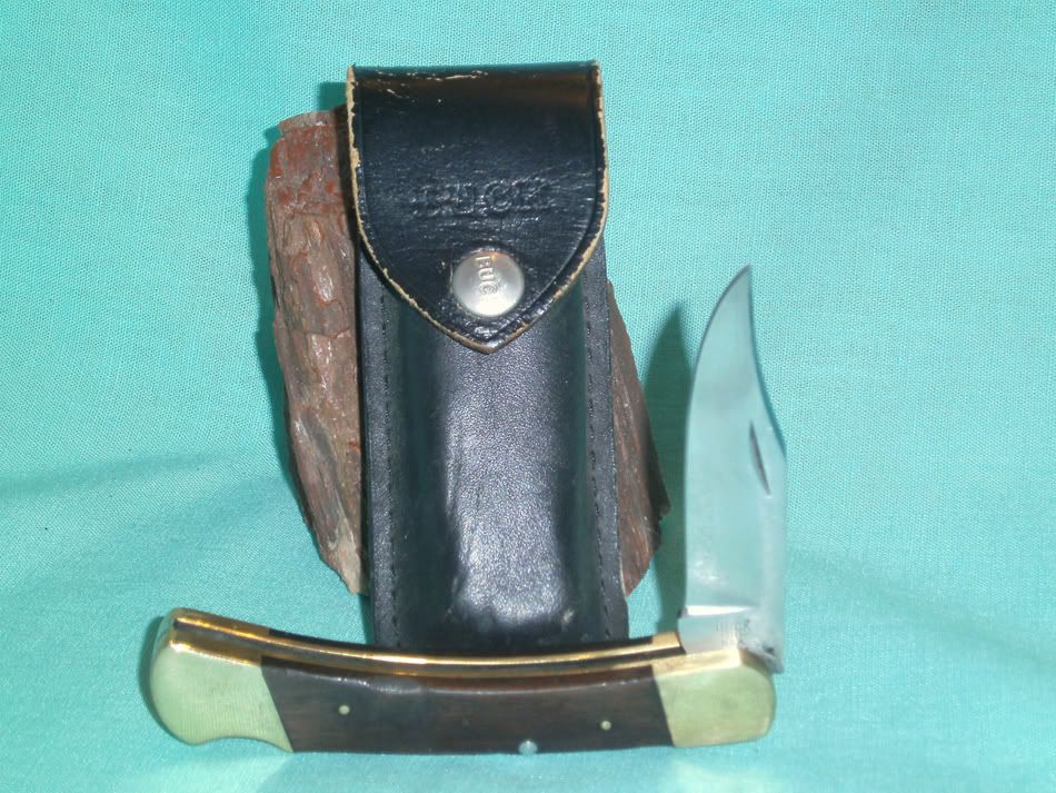

This 3 dot 110 has me puzzled. Any input appreciated.
Sep 26, 2008
8,160
This one has me puzzled. All the info that I have access to says that the 3 dot 110 (7th Version) had no variations and that it had 3 brass scale rivets. This is a three dot blade but there are only 2 scale rivets. A possible reblade or is my info on the 3 dot version incomplete? :confused:
I think it's a reblade to the closest, correctly dated blade they had. The blade that goes in that handle is a 3 line no dots or a early 2 dot. DM
I agree with David Martin; it is a reblade. Without more detail in the photo, I would say the frame/handle is a 5th Version, Variation 3 ("BUCK/110/USA" blade stamp).
Does it make a reblade more complicated due to the fact that the Three Dot was the first 110 to get a blade pivot bushing?
Was alteration needed for either the older frame that was not made for blades with bushings or newer blade that was designed to have a bushing?
I'm not that familiar with the mechanics of the blade pivot bushing, but it occurs to me it could possibly have made things more complicated.
I don't know if I'm comparing apples to oranges but Buck put a new 2010 blade in my old 1972 112.
could be a 2 dot(5thver 4th var) with a rockwell test hole-thired dot is a little higher, but I believe reblade would be best possibility.
Seems to me Joe has said that Rockwells are always done lower--where they do not show.
I dont really believe its a rockwell hole but it is possible, I believe(if memory serves) Richard Matheny has surmised rockwell hole before on a visbible, seemingly out of place dot.
I've seen lots of Three-Dots like that......it's common to see a dot that's a little off.
A Rockwell dot is supposed to be out of sight and the odds would be astronomical that it would be in exactly the spot to make it a Three-Dot.
From Joe:
I just re-read my original post....Oops!!!! What I meant to say was that the dot was in way to perfect a location to be a test dimple. Besides, they normally test blades on the tang, where the dimple wont be seen once the knife is assembled.
Sorry for the confusion.
Whatever the story, it's a great piece being that,if it is a re-blade, it's a 3dot 440C and probably has the best heat treat of the 440C blades. Interesting find and a nice 110:thumbup:

Bert, I can't answer those questions at this time. I don't have the knife in my hands as of yet. All I have are the lousy pictures I've shown so far. I should have it this week and can take some good pictures and be able to give a better description then.
Thanks for the interest.
