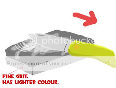

Place the whetstone on your desk/table with the rougher side up.
Spit and smear it on the stone.
Look at your knife blade and check out roughly what angle the edge is. Use something flat like a ruler or matchbox if you must.
Now place the knife on the wet part of the stone with the edge at approximately the angle you just checked. It's more comfortable to not hold the whole knife at 90 degrees from the stone. Then pull the knife gently towards you following the curve of the blade while keeping pressure on it.
See picture for starting position. :D
Lift up knife, replace and repeat a few times then switch sides of the knife.
Then repeat the whole process again one or two times. If your edge is damaged, continue till it isn't anymore.
The curve of the edge you can touch up manual by making circular motions while holding the knife at the same angle as before.
Then repeat from the beginning but now on the finer side of the stone. Don't forget to spit! :p
Check if the knife can cut paper without to much effort.
If not repeat on the finer side of the stone only while checking regularly.
Done.

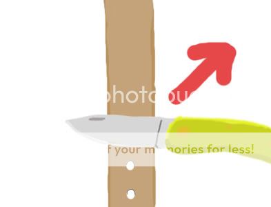

You could also strop the knife afterward with a leather belt or a glossy paper magazine. The magazine is the same technique as the stone.
Without the spit.
I use the inside of my leather belt myself.
I have my belt over the door and then close the door so the belt is fixed.
I hold the knife at 90 degrees this time at a slightly wider edge angle as with the stone to compensate the belt flexing somewhat towards the knife. Then I pull up and go sideways and also rotate the knife to follow the curve of the blade.
After a few times I switch sides and pull the knife down instead of up. Then I do the whole thing two times more for good measure.
THE END
