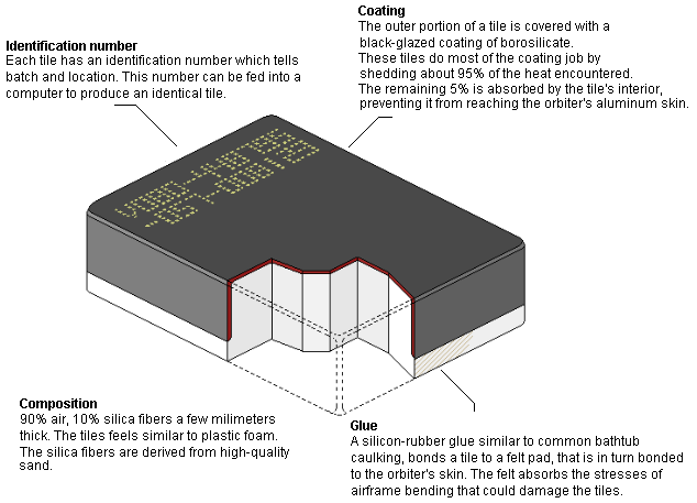

http://en.wikipedia.org/wiki/Space_Shuttle_thermal_protection_system
in a cheaper point, your average home oven can get to 900*F without a hitch. What protects the person standing in front of it? The door [which includes a glass window] and the construction of the walls of the oven.
