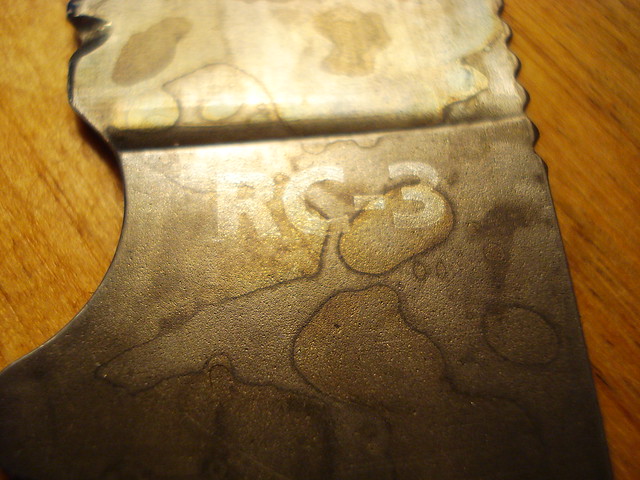

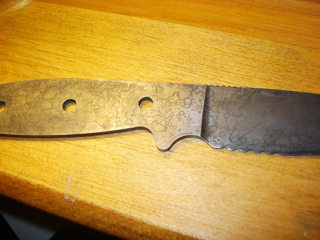

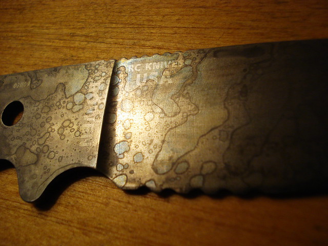

Hey y'allll, I recently stripped my RC3, then found a dremel tool, tried to polish it up to a super shine, it didn't polish the way I wanted it to.... so I forced the patina again? I think thats what I did. also. this is my first time stripping ans stuff like that, so if I am wrong in doing any of this, let me know. hahah
First off I started with vinegar, soaked it in it for a while. then washed it off, then did it again with drips.
then...mustard... You know the liquid that comes out of the mustard thing when it has been sitting a while? well I used that to drip on it. a couple times.
then I did another one with lemon juice, same thing.
hope you guys like it... I sure as hell do.
who knows, it may be removed after a little use, but... for now its sexual.:jerkit:
first time posting pictures, and it took me about a frickin hour to post them! :barf:

Cool patina, you can get a lot of different effects with mustard by how you apply it and how many repetitions.
Patina looks good !
Okay to save yourself some Grief , b/c you removed the coating under the scales the knife will rust under the scales from hand sweat ,washing the knife ,rain ,etc.
So now pull off the scales and go buy some clear coat krylon to protect the exposed metal under the scales.
