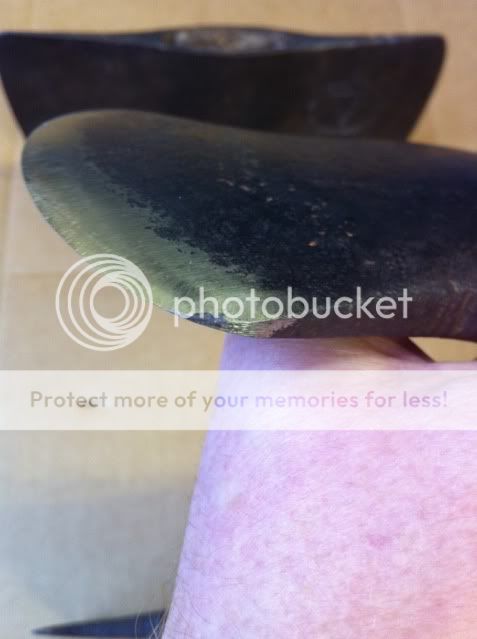

It had a bit of a chunk/flake missing on the toe/heel:
I had to be quite brutal as it looked to have de-laminated slightly. Maybe its a bit ugly as a result, but hey, its a learning curve, right?
I did most of the shaping with the belt grinder.
I have since come to my senses and have been filing with decent mill-files (actually 'farmers owns') and they really do shift metal so much better, cleaner and with so much more control.
Still work to do on it. I shall more than likely be letting it go once hung. I have a woodsy/tree surgeon buddy and I think he'll make the most of it.

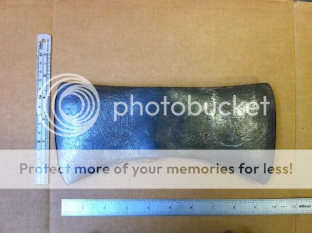

So after another DB dry spell, the same seller I bought the original head from popped up with about half a dozen different heads!
These were MUCH more like I had in mind and WANTED!!! I made an offer, no dice, so I bid and waited....I got both for a snip (well especially compared to the beat up no name).
First up a Plumb, about 3lb 2oz:
Its has a bit of a mashed socket....but I'm hopping its not deformed the eye too much. I still think it will be serviceable.

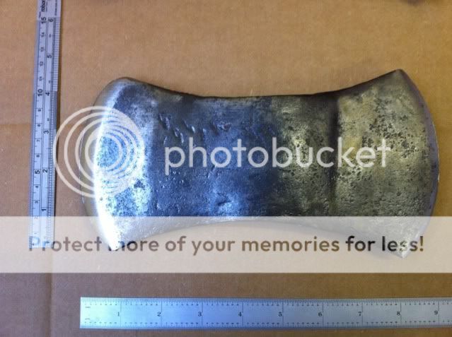

Second, and in my mind a top score, a Collins 2lb12oz!
This is THE cruiser right?! Whatever, I know this is gonna be a keeper!
I am thinking about taking a sledge handle I have, flipping it so the shoulder gives some meat to make the flare, and thinning down to size.
It’s only a relatively small, 2 1/4" eye.
Question is though, what kind of length should I be thinking?
Just file off any burrs that would interfere with the handle and it will probably be alright.
I'd go 28" but I'm sure 26" would be fine, too. I wouldn't go less than 26".
