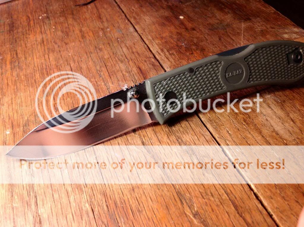

I know it dosn't look like it but this Ka-Bar dozier folding hunter has seen allot of use, but a couple weeks ago I wanted to try and mirror polish a blade soooo you get the idea:D
I don't want to get off-topic but what method did you use to MP your blade?
Well basically what I used was:
)a small (a little over 1') piece of 2/4
)blue shop towels
)mother mags aluminum polish
)elbow grease;)
Essentially I folded a sheet of shop towel into a 5" by 2" rectangle put it on the 2/4 for backing and applied compound.
then I used a stabbing motion (you're pushing the blade away from you pulling it back the repeating) and after a good 15-20 minutes I had a nice mirror polish! (Thank "powernoodle" for telling me about this stuff, the compound I mean)
the fact that the towel will conform to the blade helps allot with hollow grinds by the way (FFG blades are the easiest)
I can get all this stuff at Walmart to! (Maybe not the 2/4 lol)
and lastly remember to dull the blade before doing this:thumbup:

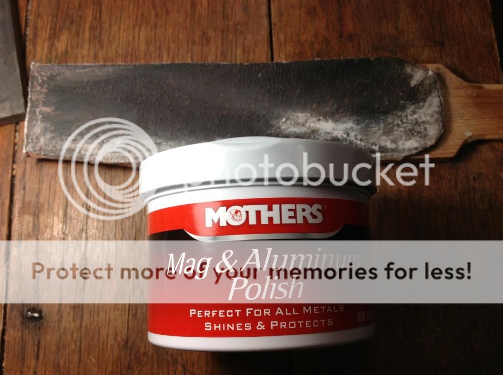

This stuff.
It makes a great stropping compound to!

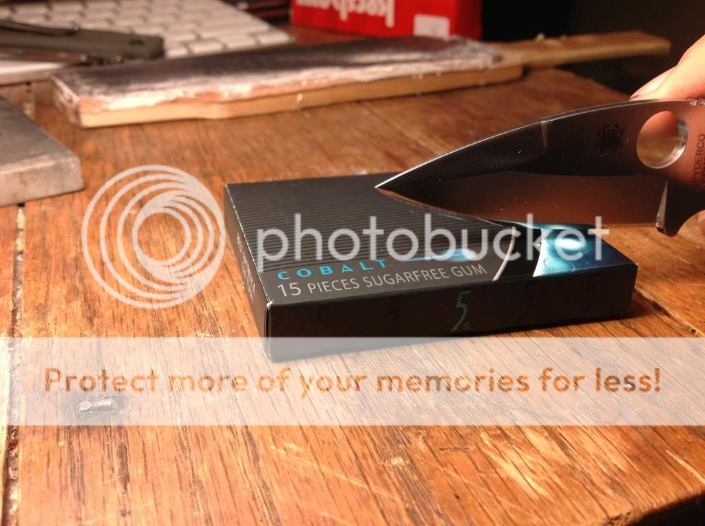

My native (stropped with mother mags)

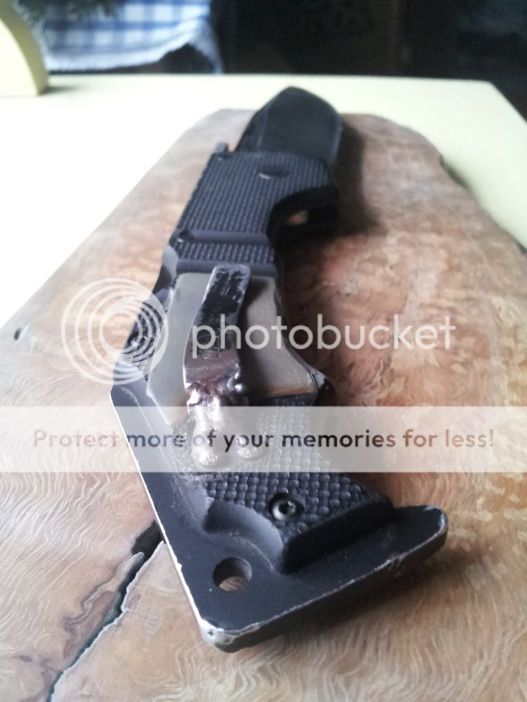

Ladies and Gentlemen, I introduce the the Cold Steel AK 47. I have had this knife for a little over two years. It has a nutnfancy clip mod (not recomended and installed before i knew better), a blade that has been reprofiled several times on my belt grinder (the blade has gone from 3.5 to 3.25 inches in legth, same as my kershaw blackout), and a clip that has been welded on TWICE (First mig then tig, neither by me despite the fact that im going to school for it).
And it still going like a champ.
