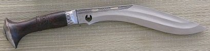

5. Since you prefer your #2 blade to be lighter than your 18.5" 28 oz WWII, a VUK or Tamang would be a good choice, or a smaller Sirupati/Chitlangi/Chainpuri. A good size for me in those models is 15"-16" long (that's overall length from tip to butt) and about 16 oz. Here is a picture of one of my personal favorites, a satin finish Chitlangi by Lokendra Kami (who unfortunately is no longer with HI). The knife is 15.5" long, weights 16 oz, and is ideal for just about everything except heavy chopping. It has an elegant shape and is comfortable in the hand. Also, this particular knife has steel bolster and buttcap (rather than the more common white metal or brass), and the "U.B." initials are in devangari script, which is a nice extra touch.
