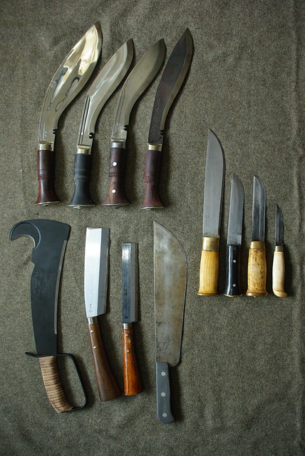

I have a 15inch AK by Bhaktta from the Christmas sales. It's my favorite HI piece and the one that fits my hand and build the best at approximately 21-22 ounces. The feel in the hand is overwhelmingly *solid*, not tip-heavy like my Foxy Folly.
Quality of manufacture is extremely high and quality of finishing is good and on par with my other HI kukris. The bolster and the, um, pommel (I can't think of the proper word for the end of the grip) are tightly fitted to the horn grip with no play or gaps and no excess glue visible. Where the shoulder of my kukri narrows there is some slight unevenness in the width, and that's the only visible inconsistency I see in this item.
I'm surprised by how much I like the smoothed but unpolished horn grips on this kukri. Left to their own devices they quickly get small scratches and acquire a roughened look, but rubbing a small amount of oil on the horn seems to expand the pores of the material and magically smooth the material to a glossy black finish.
From left to right, top row: 16.5in Foxy Folly, 15in Ang Khola, 15in Bonecutter/Ganga Ram Special, 15in Tamang Knife.
I've only had a couple chances to use the kukri so far this year. I tested it on a 2x4, even on a casual swing it sunk more than an inch into the wood and tore out great chips. Then I used it to chop up a squash for dinner. I used a light swing, aiming to split the squash in two. I bisected the squash, split the cutting board down the middle and chipped the tile counter underneath. Whoops. Anyways, it kills stuff. It kills stuff dead.
