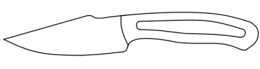

I recently started a knife similar to this, but I wasn’t happy with the way it looked, so I changed the design a bit more. Any thing I should change to make it better?

Ways to make it "better" are going to be of opinion...
Me personally I don't like sharpening coils, and I don't like harpoons, especially on a small knife.
But those are just My opinions. Some people might love that stuff. You should make the knives that YOU want, my opinion, or other people's here, doesn't matter.

What is the blade thickness, and what sharpening angles, bte thickness, too?

I really like the pommel, looks like a comfortable handle.
If you are deadset on a “harpoon” i would bring it back and make it more of a ridge for your thumb instead of up further on the blade but heck it doesnt look bad as is. Somebody would love it, thats the great thing about knives.
Thanks for all the feedback, fellas! I understand that the harpoon point might not serve much purpose in a utilitarian sense, but I wanted something with a bit more visual interest than a drop point, and I don’t love how a straight clip looks on a knife with a lower tip like this one. I drew inspiration from Scott McGhee’s Piranha and XO models; I figured that being a master smith, he wouldn’t put a raised clip like that on a using knife if it made it harder to use. I started a blade in a very similar pattern to this one, and I like how the raised clip feels, but that might change with scales attached and everything. I think I will go ahead and do away with the sharpening choil, though
You said you don't like drop points..... Then maybe don't make it a drop point.
If it's a hunting knife,
What about bringing the tip Up higher?
I could imagine it looking pretty sweet as a straight-back
Overall a great profile. One of my favorites. The only thing to adjust, to my eye, is that the blade angle can be canted down just slightly to continue the curve of the spine all the way to the thumb ramp. It's subtle but something like this:
