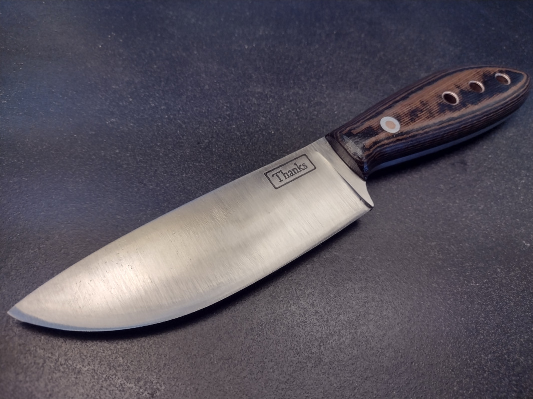

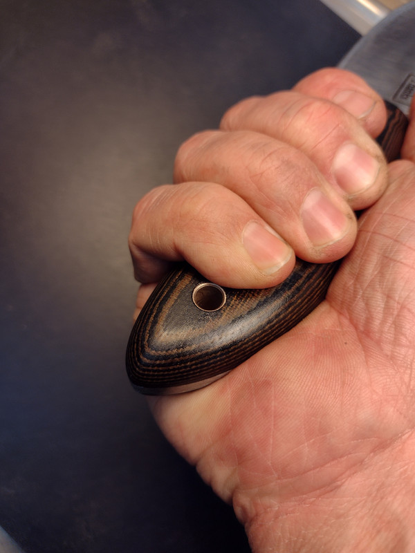

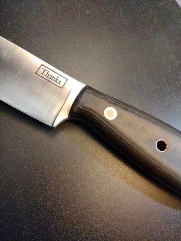

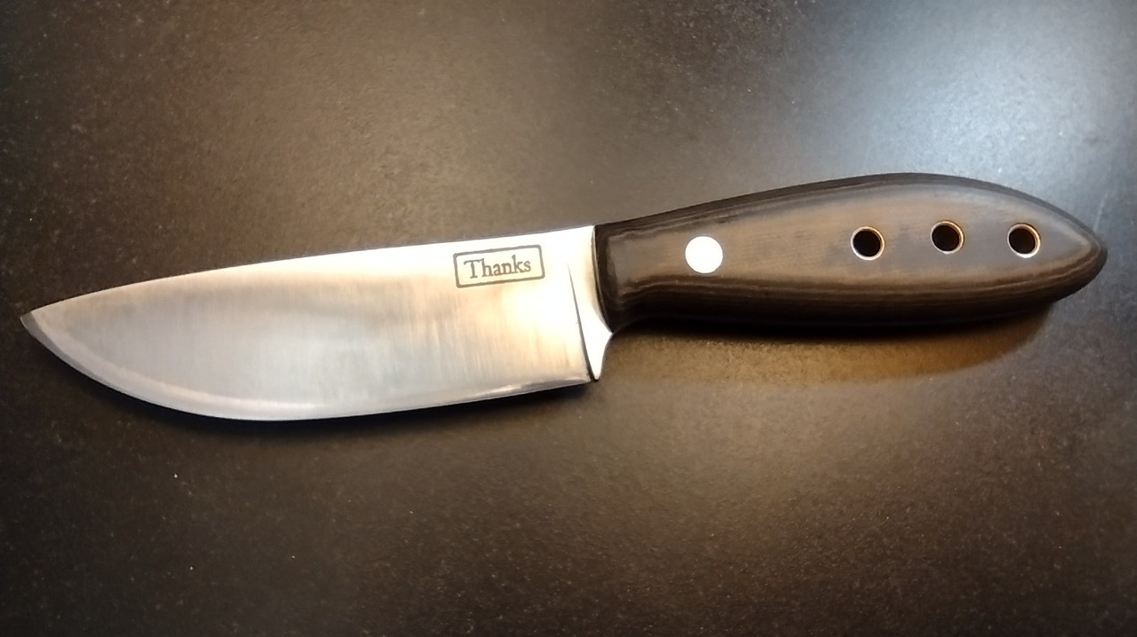

A lot of folks like them. I used to think it had to have a full guard covered with handle material to be safe. But after having made and used quite a few with the "forward edge" design, I have to say I really like it when it is done well. To me done well means that the heel is rounded or angled away from the hand enough that you don't accidentally pierce yourself on it if you are using a choked up grip on a cutting board, and the steel around the guard is chamfered to prevent discomfort.

A recent one was made with slab, non contoured scales for that very reason if Not twisting in the hand. Your fingertips register perfectly for secure twisting of the knife into work.
