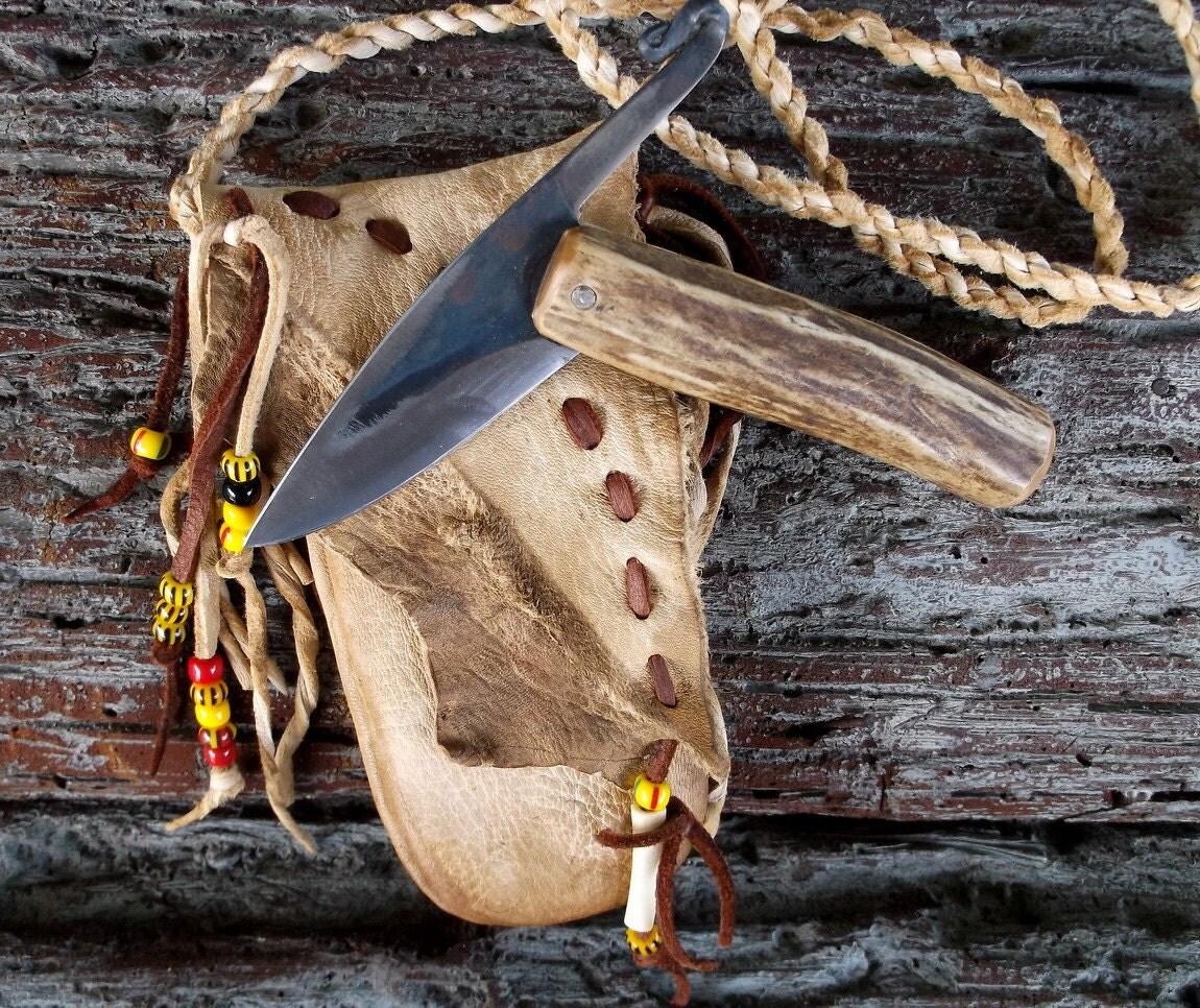

As far as I know, the sodbuster is more of a blade shape. The knife is a standard slip joint … with a back spring. The spring applies tension to the tang of the pivoted blade to hold it in the open or closed position. The backspring on a slip joint is pinned at the non-pivot end and roughly in the middle. The spring is often reduced in thickness between the center pin and the tang to adjust the tension.
I would suggest you make a standard friction folder. You could go for a "Mountain Man" type folder where a stag crown or other piece is used for the frame and the blade is forged with an extended tang. Some are super simple, and some have an external backspring and ring pull to open and close.There are several low cost books on making these type knives. The books, "Little Uglies", and "Antler and Iron" come to mind.
754369e7468ca23eed02046553ff0d79db4502e5.pjpg
th
That is just a thin brass escutcheon plate, but I do see what you mean about it looking like a diamond shape turning tool insert.
What is this "ring pull" you speak of? Is that some kind of a manual lock? I'd be interested in some ideas for simple, manual locks too.
The ring or lever on the spine is used to lift the backspring so the blade can fold shut. The spring also applies pressure on the blade tang when closed to hold the blade in the shut position. This is an improvement on the simpler friction folders with nothing but the pivot friction to hold the blade shut, and the extended tang keeping it in place when open.
Do a search on "Friction Folders" and "Mountain Man Folders", or buy one of those books. They explain it well. You will find this style called a "Blacksmith Knife", or "Folding Blacksmith Knife" in some countries and in old smithing books.
