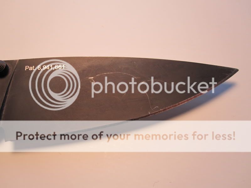

Are you talking about more of a scratch or a chip? Would love to see a pic if yours is actually chipping away. Here's a pic of the Aegis I referred to in the video that had a big scratch on it:

Sorry i sold off my para2, so i can't post any pictures. But it's a chip, not scratch. Probably got it when i dropped my knife on a tile
