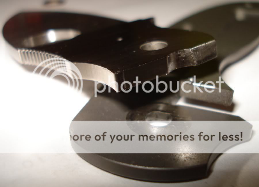

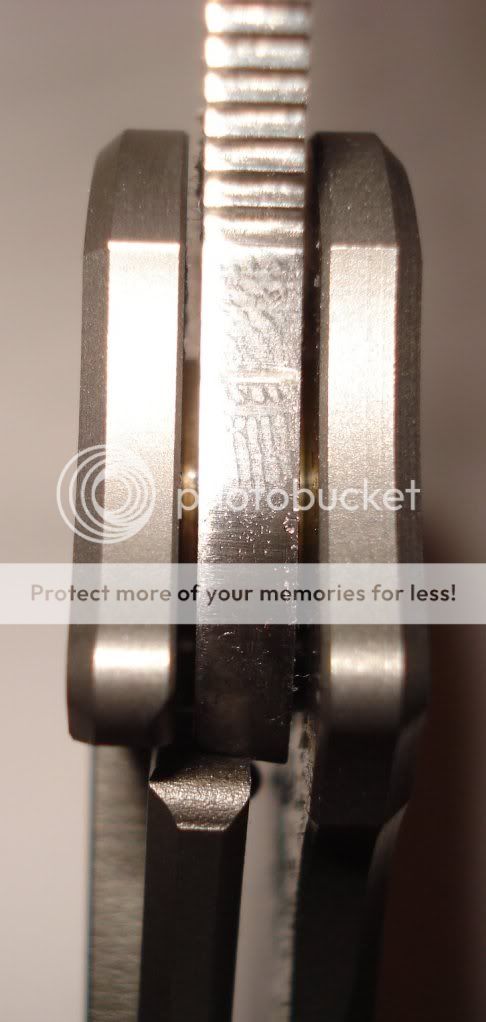

I still rate it as my #1 knife. I've probably opened & closed it several thousand times. I tend to do that when I'm watching TV. I'm right handed, but I switch hands; right and left doing this.
I suspect that it'd take years of use before the lock bar engaged 100%, but I think there has been some wear. I'd appreciate others opinions.
This is not a very good picture, but it is the only one I have of the lock bar when the knife was new.
I don't seem to have the correct tool to take the knife apart. I thought it was a T7, but that doesn't seem to work. If anyone knows what I should be using please tell me.

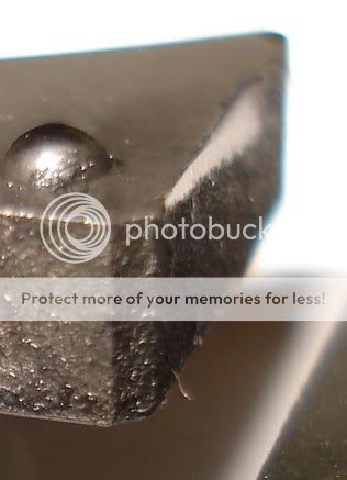

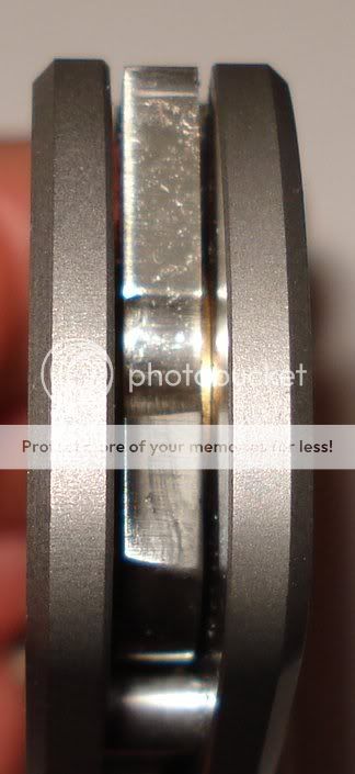

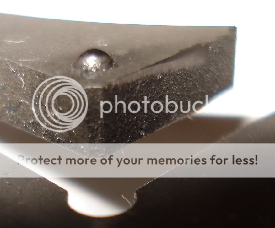

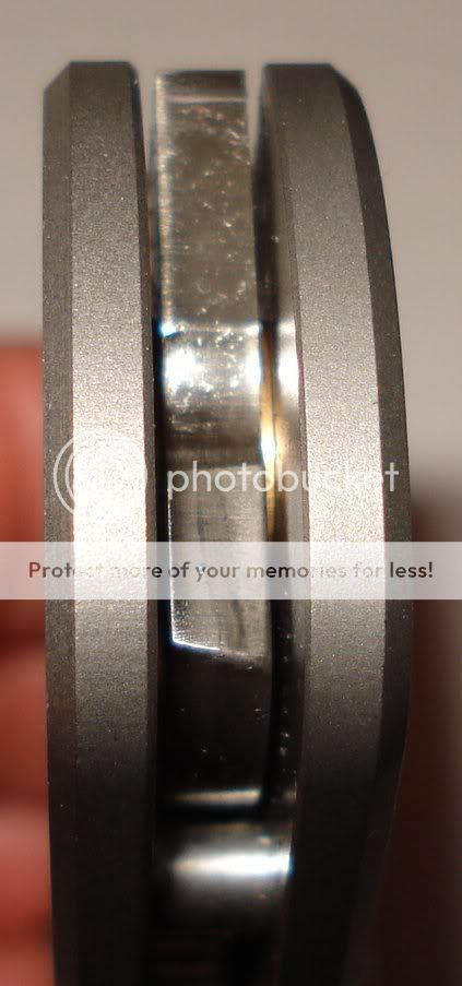

The following pictures were taken today.
I can't tell if this is metal shavings or just dust and such.
These next two pics show the lock bar engaged. You can compare it to the first pic to judge wear.
Now, these last two pics are of the tang where the lock bar engages. There is a slight smudge. Since the S30V blade is harder than the titanium lock bar I guess it is a transfer of titanium to the tang.
So, what do you think?
titanium without a treated lockbar (Sebenza) will wear in faster in time.
Plus, it looks like you got some lube on the tang and lock face maybe that is that's causing it to travel further?
Also, if you push the lockbar it will travel further as with all Reeve locks. (happens with my sebenza)
:confused: just my very ignorant guess. :foot:
my experience has been for a framelock to wear in to a position and then remain there for quite some time.
That's what I think has happened to mine. I can't see any wear on the surface of the lock bar so I think it's just normal break-in. I'll keep an eye on it and report back if I notice unusual wear.
It was a T9.
I got my knife apart today and took some more pictures. Due to lighting and angles some of the pictures may be a little misleading. As far as I could tell there really isn't any wear other than a smoothing of the rough finish on the end of the lock bar, which I take for normal break-in wear.
