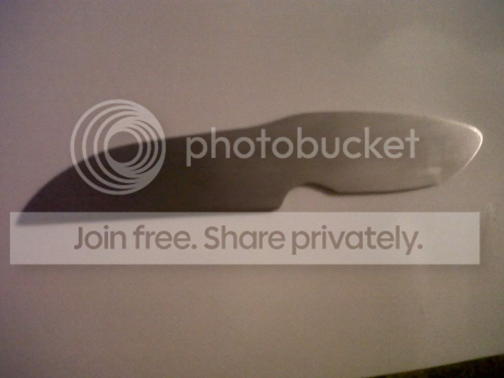

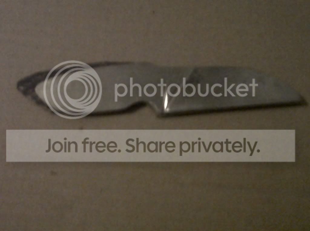

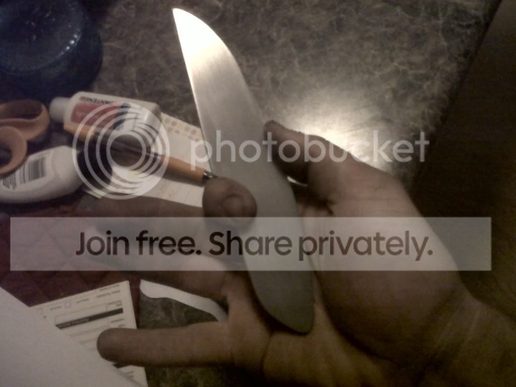

Drew this out yesterday and cut it out of 308L today. Feels pretty good in the hand what thought do yall have about it?
My first thought would be that I would like to see a deeper finger relief to prevent you from sliding up onto the edge with your index finger. So a slightly deeper finger groove that is blended back into the handle swell.
--nathan
What function is the knife intended for?
If it is a slicer, the handle is too low, and your fingers will hit the counter before the blade does. If it is a utility Wharnie, then increase the finger grip deeper and thin the handle as Nathan suggested. The handle is a bit too fat anyway.

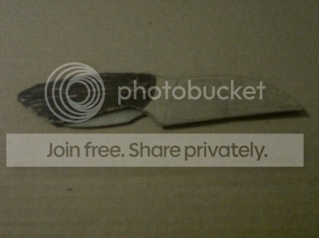

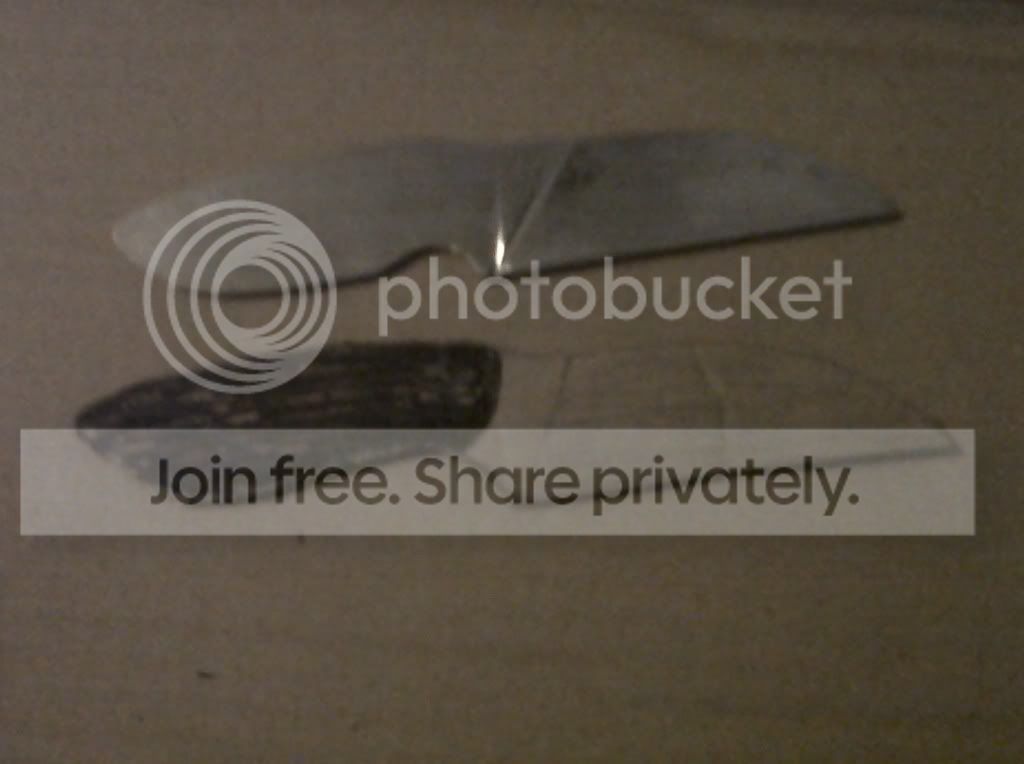

Here's a wharncliff I did a while back. Now, keep you design elements as you want them to be, but this may give you an idea on what I was referring to for the handle:
You can see it's deeper at the finger groove and it blends into the swell. Now, with your shorter handle, I understand why you want a thicker grip, so you may want to try experimenting on cardboard to see what feels right. Remember, once you take metal off, you can't put it back.

I don't believe the handle is long enough for the blade size. Most wharncliff blades are used with the edge parallel to the cut which makes your handle a little low.
Fred
It is intended to be a utility style blade, I see what you mean about the finger groove being alittle shallow and I am considering deepening it but I like the thickness if the handle because I have large hands and it helps to fill them out.
