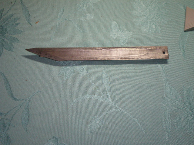

I think if I was a woodworker, Id probably have some scrap used planer blades
I'd just grind one of those out myself on a proper planer blade sharpener, or disc sander.
Like this, I was wondering when my shop life went to pieces, at one time I was a happy woodworker and then I made this from a planer blade, and now look at me!
