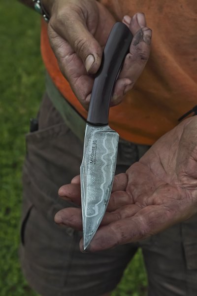

I forged my first Damascus billet just after the San Antonio show, but only recently completed two knives from it and have another project from that billet in progress. The billet was made from 1080 and 15n20 that I got from Kelly Cupples, and all three works will be with me at Blade - Table 21R.
Let me know what you think.
I forged and finished a delicate version of my EMc design first. Then decided to Parkerize it after it was completed, as my Parkerizing tank wasn't set up yet. I think the blade came out well, but five minutes in the tank (what I read was recommended) seemed to make the finish a bit blotchy. I decided to make this knife my everyday carry and adjusted the amount of time I leave blades in the Parkerizing tank. I've since gone to one minute in the tank, and the finish on the next one I Parkerized came out much cleaner.

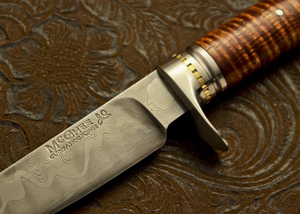

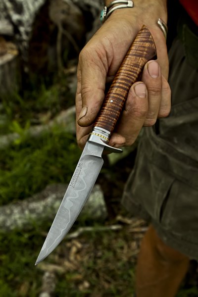

For my second pattern-welded blade, I went with a tribute to Jerry Fisk's Sendero. We're calling this little bird and trout The Kestral. I didn't Parkerize this one.
The Kestral
Steel: Pattern-welded 1080 & 15n20
Finish: Hand-sanded and etched
Overall Length: 9 1/2 inches
Blade Length: 4 1/2 inches
Spine Thickness: 0.141 inches
Handle: Flame grain Koa with coined bronze and filed stainless spacers

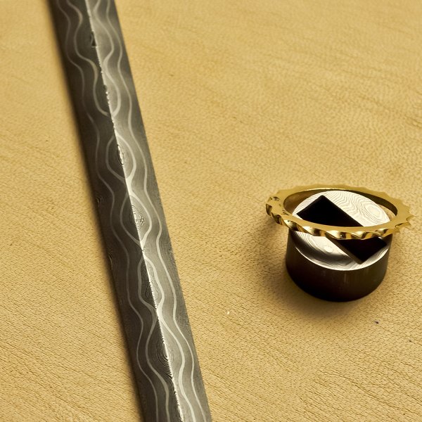

I added some laddering for my final project out of this billet. This is still super secret squirrel stuff, but here's a sneak peak. I did Parkerize this blade, and Lydia will add some more shots closer to showtime. Think copper, bronze, wood, and Damascus.
