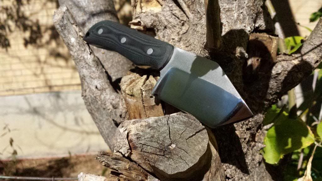

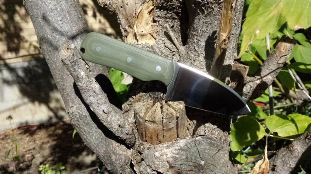

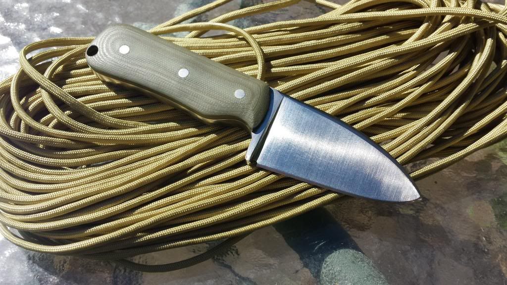

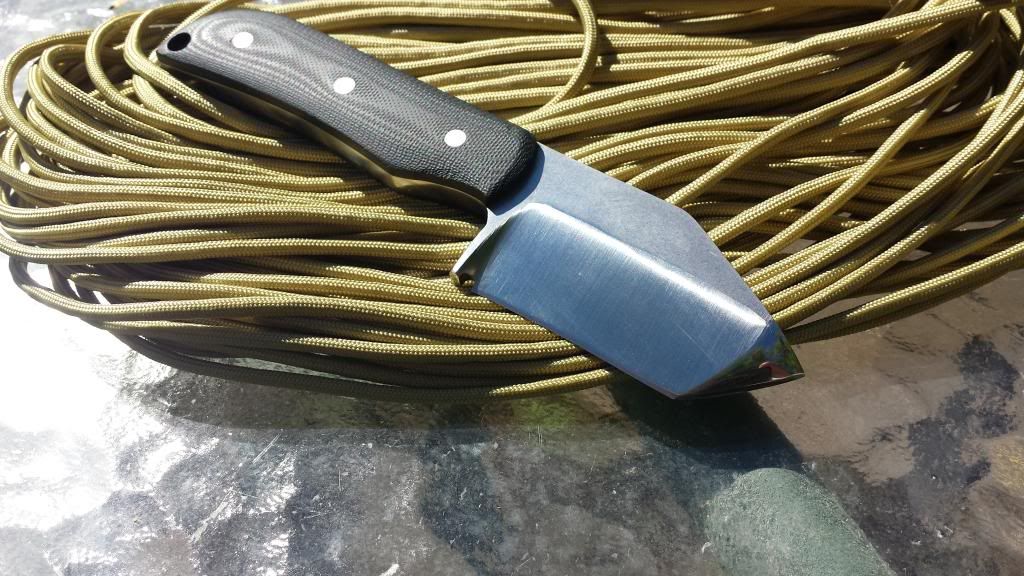

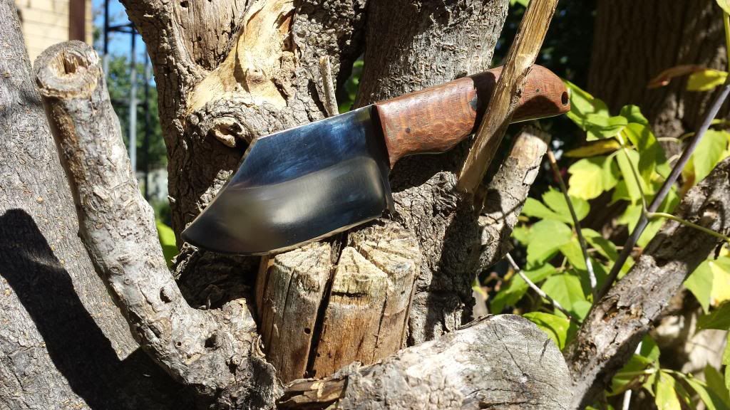

Hello my name is Justin and i'm just getting into making knives. All three knives are made from D2 steel and HT to 59-60 Nitrogen quenched. They hold an amazing edge. I sent a knife i made around to a few knife nuts on youtube for review, after all of them testing out the blade and cutting tons of cardboard, it came back just as sharp as it left. All blades are from 6 1/2" to 6 3/4" long and 2" wide. The weight on these beauties are from 6-8OZ little heavy from can really perform and have a edge that can pop paracord. With the thickness being 1/4" they cut like they are half the thickness and are twice as strong. I have medium to large hands and they fit beautifully in my hand. All the handles are CC and the G10 is beadblasted for grip. The leopard wood is smooth and polished nicely and buffed. All the blades are taken up to 220 grit and scotch bright and buffed. Also all the knives come with a kydex sheath. The tanto has a CF kydex sheath, bowie Has a black kydex sheath, Drop point has a 1/2 black 1/2 OD Green kydex sheath. The tanto have a mirror polished tip. They are for sale check out my post in the sale section.
I like the structure of your blades. It simple but I think you crafted it very well. Crisp and sharp. Nicely shaped and executed. Great job.
