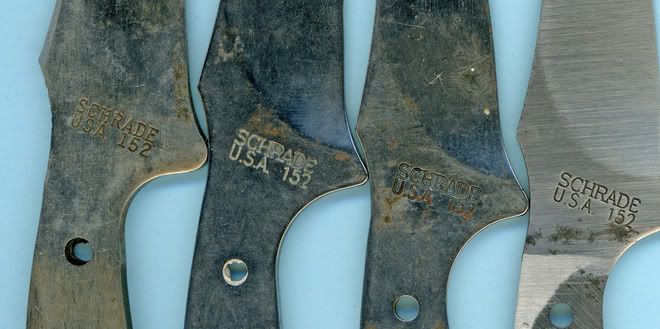

I was looking at some 152 blanks I got from LT tonight to see which I was going to do next. I laid 4 of them out on the work bench and immediately noticed a big difference between them.
The one on the left had 152 stamped in it with the serif on the bottom of the 1. The others do not, the bottom of the 1 is sans serif. In addition the one on the left measures at .169 inch ant the others are .124, .121, & .123 respectively.
QUESTION: When did they change the thickness of the blades? Can it be tied to the change of type styles? Does anyone have a knife made of thinner stock that has the serif style 1? I have a 154 with serif that is the thicker blade stock. I have a 156 that is thinner stock but has the serif, though I am not sure that is a good comparison because I think it is one that was made for the Anniversary not not finished for it. My wife bought it off ebay & gave it to me at Christmas.
Has anyone noticed a correlation to blade thickness and the type style? Or have I gone off my meds? :eek: I think I took them today, ( I take Ginko to remember to take the others) :D

I believe that the stock thickness variations are just an artifact of the steel stock available at the time the knife was blanked (and finish surfacing by Schrade), and does not correlate to the tangstamps.
I'll check my own few sharpfingers when I get time, meanwhile... any of you interested in furthering the cause of scientific Schrade Sharpfinger research... send me your sharpfingers and I'll do a complete dimensional analysis and post the results here. Alas, I have gifted all of my sharpfinger blanks to the youngsters and oldsters with a yen to make a knife, so except for a LE sharpie or two, Blankmeister is blankless.

I found another 152 that is sans serif at both top & bottom of the 1. It is a different thickness yet, about .137". I also have a Schrade + 152 DU blank (stainless steel) that measures .140".
Codger,
I bring these to your attention because it is another possible angle on your research. You had wondered if it was possible to date the knives by the style of the sheath and or type style (if I understood your original post in this thread). It is possible that the steel thickness also plays into this dating process.
I would hazard a guess that as steel prices went up, steel thickness went down. However, I am no expert on the American steel market, but it might be an another angle for you to look into.
I hope this is helpful. Who would have thought that this could have gotten so involved. I almost becomes an exercise in minute details. I guess we all knew that Schrade didn't keep good records (at least not that are where we can find them).
