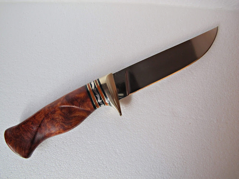

Knife No1
Stainless steel blade made from Russian steel 95X18, which can be considered to be close analogs of AUS8 / ATS34 / 154CM
Cutting edges are forged to HRC 58-59. Tested and it's an excellent slicer!
Blade thickness - 3.7 мм
Bronze, black micarta, amboyna burl.

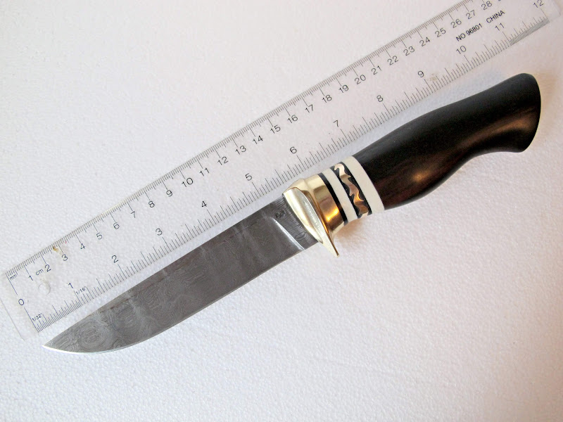

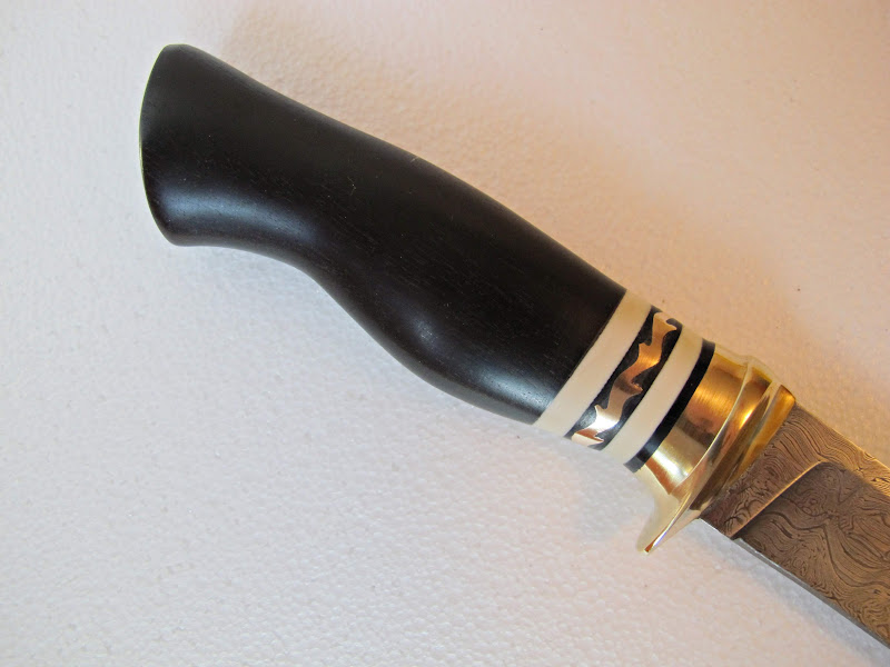

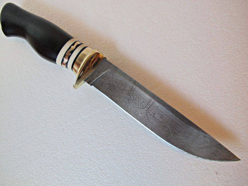

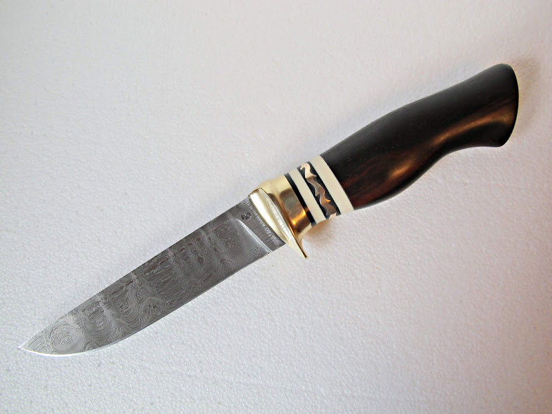

Knife No 2
Damascus blades on this and two other knife below have over 500 layers of folded and welded steel and made from four types of Russian steel - steel for bearings ШХ15, tool steel У7 and stamp steels 4Х2Н4МФ, 4ХВМФС
(Approximate analogs would be, accordingly, 154CM / ATS34, D2, W108, 52100)
Differential head treatment. Cutting edges are forged to HRC 59-60, spine a bit softer.
Blade thickness - 5 мм
African Eben, simulated ivory (elforin), bronze, black micarta.

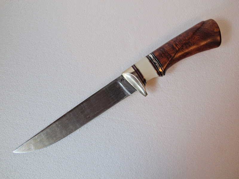

Knife No 3
Same Russian made Damascus, thickness - 3.5 mm, pretty long blade - over 16 cm.
Bronze, stainless steel, dark red micarta, elforin, amboyna burl.

Knife No1
Knife No 2
Knife No 3
