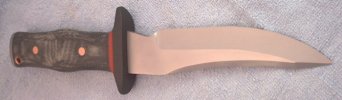

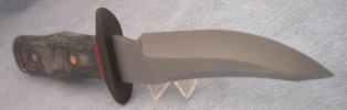

Latest Blade design for the initial series anyway.
Still working on the picture taking.
Will post trio soon

Final versions of the blades will get all Black G10, smaller Choil, two pins with a thong hole, Steel pommel cap, and maybe a SS accent spacer behind the guard.
This particular blade has a really nice slicing edge along with a strong spine. Has the abilty to be double edged at customers request, maybe add some teeth:eek:
madcap_magician said:
I like this one, but I liked the first one best.
Have to agree with you I have always felt the Musso bowie style blade is a superior fighting design.
Strong as hell, an extended point for penetrating thru a breast plate or getting between the ribs to vital parts!
Have made these with the upper half done in a flat grind (Still leaving a 5/32nds" spine) taking out a bunch of blade weight while leaving full thickness thru the center to the point.
This has the added benefit removing the catch point a full thickness spine has.
Splain...Well if you happen to take a swing and catch the oponents arm or whatever they were dumb enough to expose, the blade would continue on thru unimpeded. Living flesh has a habit of closing around whatever has penetrated it. Yuk
Not to say that this smaller version is anywhere near as effective as a full sized Bowie in a fight. But it is a well thought out design...Those guys back then knew their stuff.
