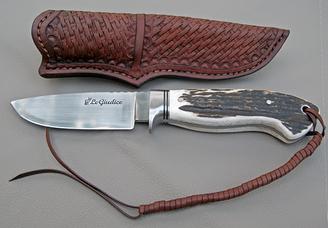

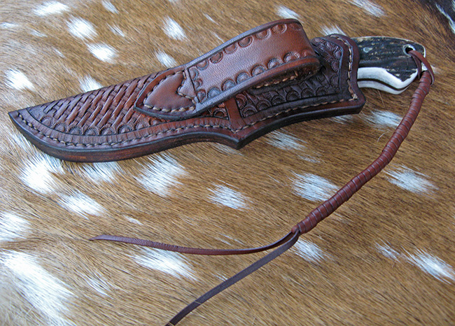

Here's a few photos of some knife/sheath combinations that I recently completed. It's been nearly a year since I last made any sheathes, and it shows in minor tooling and staining blemishes. In any case, I still think they came out well.

Michael, those knives are fantastic, I especially like #41.
A thought on your basket weaves, if you don't mind. I've had much better luck with mine since I started having the "heals" of the stamp match from row to row. On the photos you seem to have put them end to end, stretching the pattern out a bit further than it should. It will take a few more impressions to cover the area, but it might very well help you clean up some of the issues you think you are having.
Chris
Chris,
Agreed. I've had a hard time lining up the ends with the tandy stamp that I have. I just ordered a JW Watt stamp that appears to have much more defined marks at the "heals". If this doesn't help, I guess I'll just need to stamp some throw-away patterns before starting work on new sheaths after a relatively long hiatus.
Mike L.
Looks great, I like how you did the end of your belt loop stitching, not going straight across helps prevent tearing down the road sometimes.
