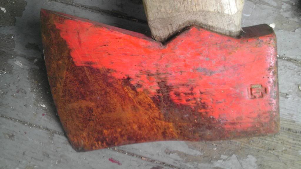

I came across a bucket full of old axes going for about $5.-$10. each.
I'm thinking about getting at least one of the big felling axes @ 36".
Is there anything I should look for besides obvious markings of makers?
I'm in rural West Virginia, so I'm hoping to come across some good vintage stuff.
:D
Look for axes with long pointed toes. Also check the bit for grinder marks - the temper could be ruined. The older axes (pre-1960's/1970's) tend to have better steel. One good indicator is convex cheeks (sometimes called a high centerline). Another good indicator are ridges inside the eye. Those are usually good axes made by the major manufacturers, even if there's no stamp on the axe. Many of those were made for resale by hardware chains who applied their own paper labels to them.
Pretty much just geometry and lack of abuse (too rounded of a bit, grinder marks, too much of the bit removed, etc)
I look for axe patterns I like (or dislike - I dismiss Michigans immediately); I look for alignment, cracks, and any other potential issues;and then convex-ness in most axes (except Maine patterns).
Mainer's often still have a high centerline Coop, just not as much of one due to the thickness of the wedge shape in itself regulating depth of cut.

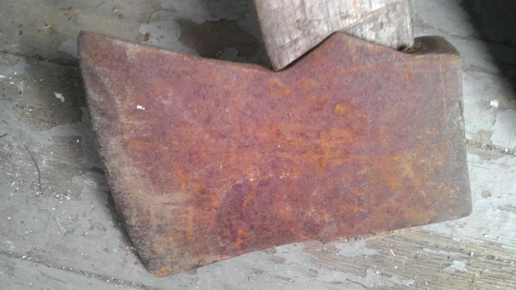

One looks like a "Rockaway" and the other like a standard "Wedge".
I believe the Rockaway is fastened with 2 circular steel wedges and
the other one has wood missing in the eye with no wedge visible.
I might be a few and practice my restoration skills and if I have keeper,
I'll give that one some extra special treatment and give the rest to my
family members that can use them.
Matter of fact, I'm going to check them out now.

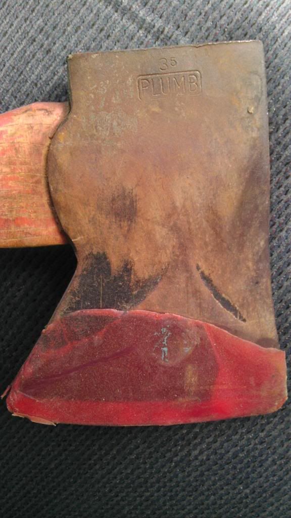

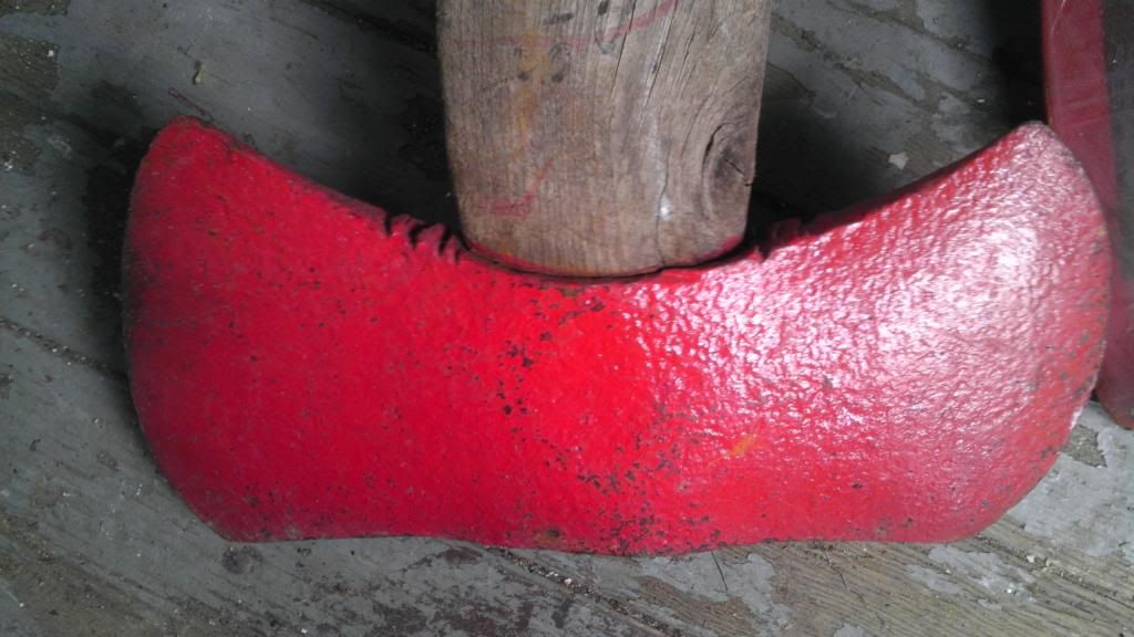

Looks like a True Temper, a Plumb and maybe a Collins along with a few others that I can't get
a name on. Have at it. Axes $10.-$15. and handles $5. Let me know which are worth anything.
I can't find stuff like that around here. Looks like a lot of fun work ahead of you.
Wow! Nice haul. Love the Plumb.

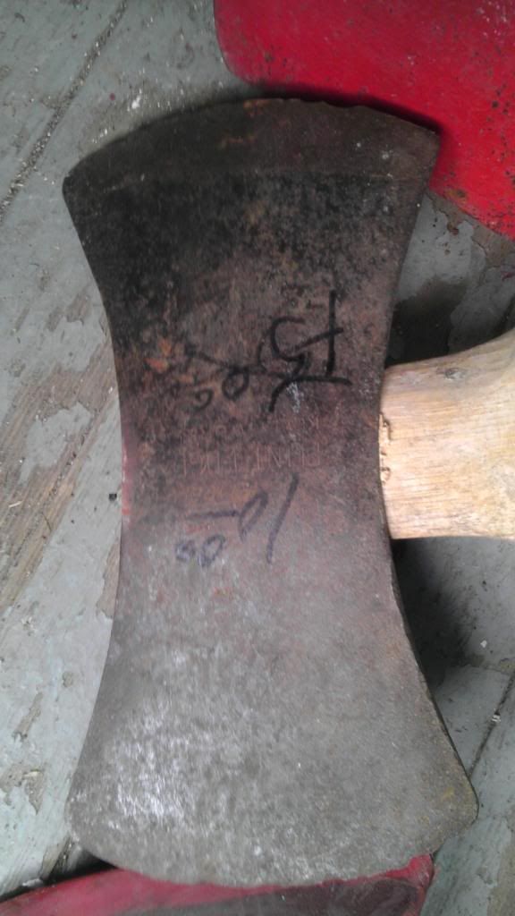

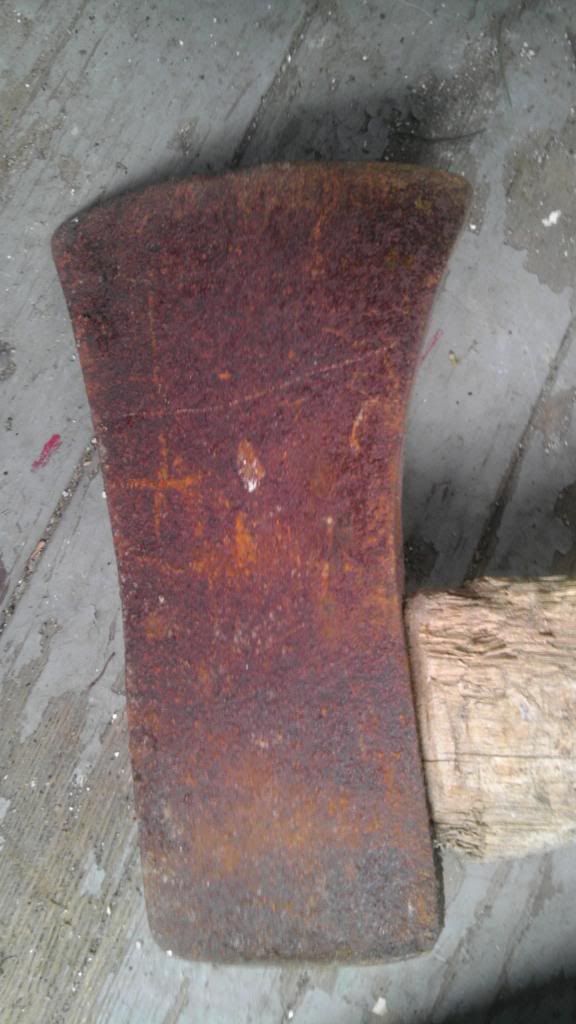

That 5th one - a Jersey - I think that's a Council. That next Jersey looks like a fine axe, too, just needs the rust removed. The 2nd double bit looks pretty worn. It might be a cruiser.
Thanks. Going to pick them up tomorrow. I'll clean them up and re-handle the ones that need it and refurbish the decent handles. Then, when I get out into the sticks, I'll see what they're made of.

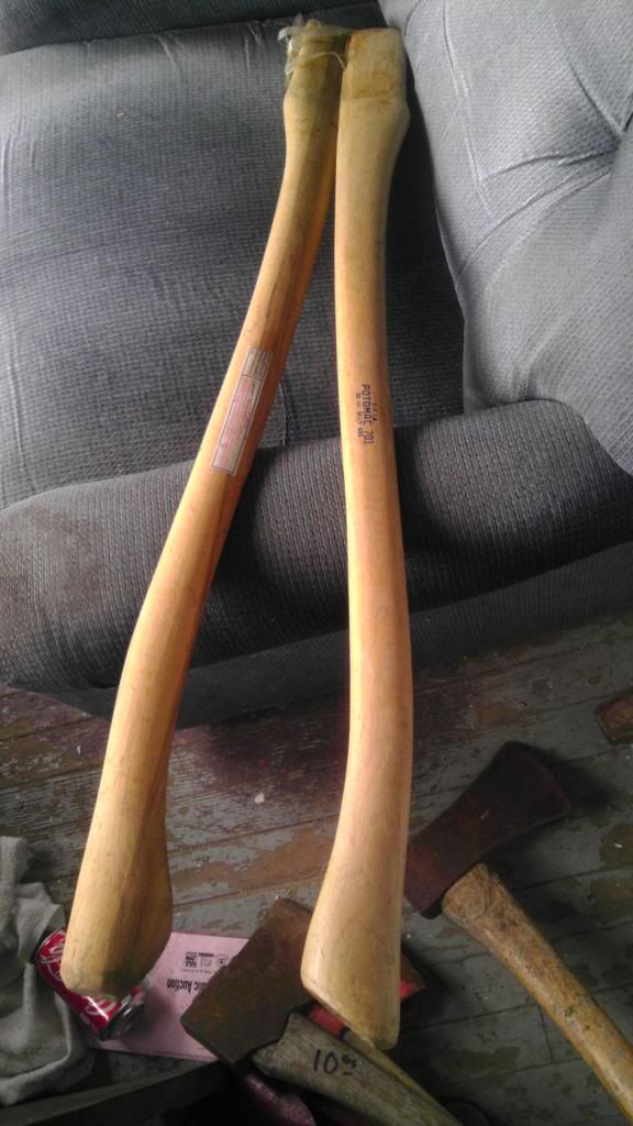

Questions:
What do you guys think about these handles for $5. a piece? Yay or nay? Worthy?
Or are there better alternatives quality-wise even if they cost more?

I'd just give them a good scrub to take off the loose rust, then hit them with something like fluid film or used engine oil to protect them until you can "clean" them up on some timber. Then they will patina with age and sap and the like. Nice looking find man!
I would buy those handles for $5. I've cleaned up a lot of axes and other old tools just with steel wool. It takes longer than with a wire wheel but it's about the cheapest way to do it.

love new old stock handles. i would.
Definitely. That's why I had to ask. Sometimes, old stuff is good, sometimes it's not.
He has about a dozen brand new old stock handles that look all to be in excellent shape.
