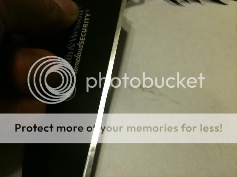

I use a Lansky sharpening system down to the 1000 grit stone and then whip out the Dremel with a felt wheel and Craftsman polishing compound. Gets my knives shaving sharp.
Terrible picture, but that was a short pass on a spot on my arm I test all my knives. $35 knife made of 440c.
