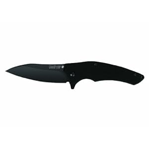

I've seen a couple of folding knives that use the thumb stud as part of the locking mechanism in order to prevent the blade from moving up any further after it is deployed.
For example;
images
I have stayed away from blades that use this sort of feature involving the thumb stud for this process, because i feared in time that the thumb stud would get loose from it flying into the frame to prevent the blade from moving up any further, or the thumb stud would fall off.
Is this really something I should worry about, or is it more of a problem for cheaply made knives?

I wouldn't worry about it. If you're using a folder that hard you should be using a fixed blade or a tool designed for the job. The only flaw that I found with the thubstud blade stop is when wearing gloves. Sometimes the fabric gets pinched between the thubstud and scale.
I appreciate everyone who took the time to type out a message and give their input to this thread. I wasn't concerned with the thumb stud on the Strider, but just the thumb studs on any folder that uses this type of mechanism.
I was asking because I was considering on getting this Kershaw knife that uses this thumb stud locking mechanism. The Kershaw Turbulence.
From what everyone has said, I feel like I made a good choice with the knife I picked.
