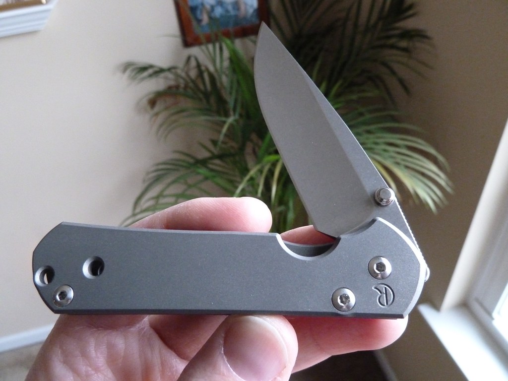

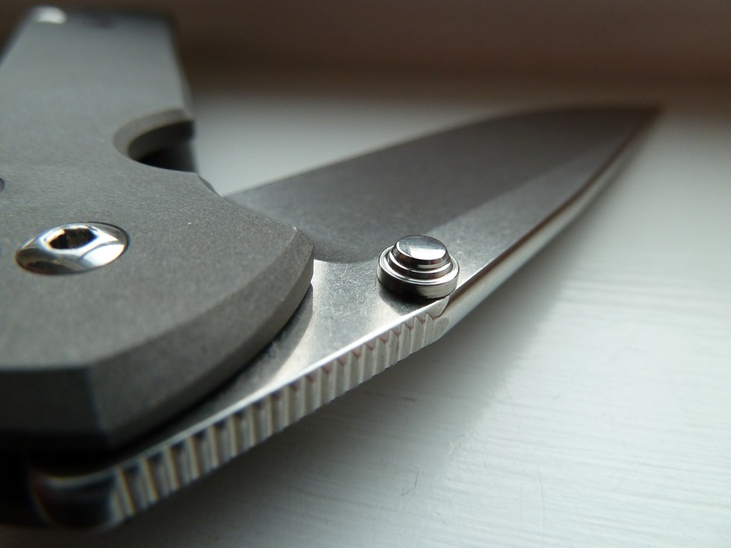

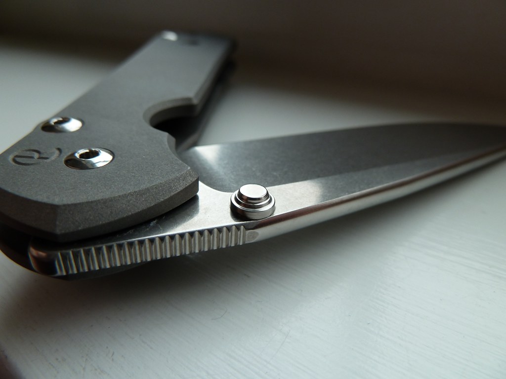

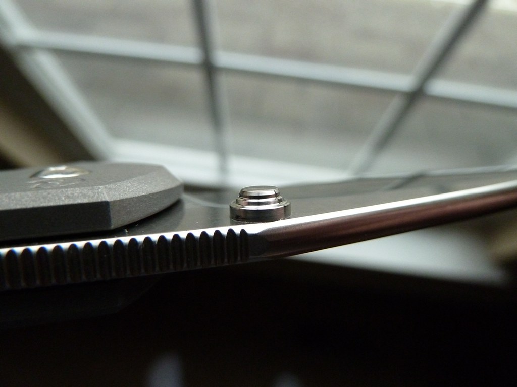

As many have said, CRK puts the pointy thumbstud on for a reason. But I just couldn't get used to it, and this simple mod made this knife perfect for me.
Thanks for all your help in making sure I didn't totally destroy my new Sebenza. This combined with having CRK swap the blue for silver has made this the perfect blade - period.
Here is the process I ended up using to do this mod start to finish:
The results
Thanks!!
-Rich
- Dis-assembled knife
- Wrapped blade completely in thick layers electrical tape, including base of thumbstud
- Used a Dremmel to grind thumbstud down to what appeared to be close (but not all the way) to the depth I wanted
- Wrapped an Altoids (Smalls) tin in 1,000 grit wet/dry sandpaper and sanded down further, focusing on creating a very flat and level surface
- Wrapped the Altoids tin in 2,000 grit wet/dry sandpaper to finalize the surface and get ready for polishing
- Took a small piece of 2,000 grit sandpaper, and (by hand) slightly softened the outer edge of the newly flattened surface of the thumbstud
- Used a Dremmel with a buffing wheel to buff the flat surface of the thumbstud
- Used a Dremmel with a pointed buffing tip to do more detailed buffing of portions of the thumbstud that still needed it
- Re-assembled knife
- No more pointy thumbstud!
