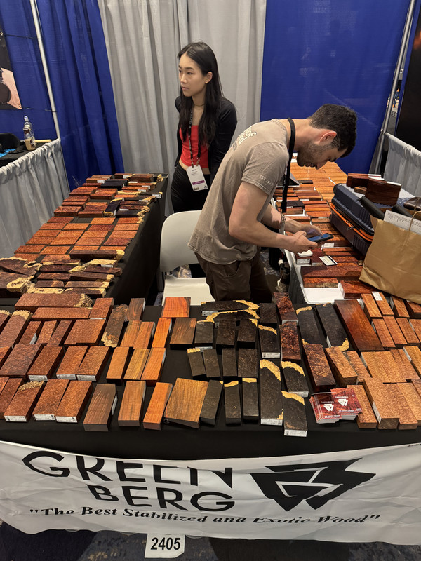

Yep, Ben's a great guy. Been buying some very nice Siam Rosewood from him over the last year. Met him Friday morning at the Blade and spent $$$$$ on more Siam. Amboyna Burl is his favorite wood and his table was loaded with it.
Here he is looting me of the remainder of my discretionary funds Friday. He was loaded with the good, high grade stuff. He even had some one of a kind cocobolo burl I'd never seen before. Pretty!

I met him Saturday and he took a lot of my money as well. He was like “thank you! My wife doesn’t want to have to drag all this through the airport again”. Super nice guy.

And he's much more competitively priced than the other guys that I won't name.
His products there were finished beautifully, for display. Better than usual. Asked him about it and he told me he only took his blocks down to 220 grit then polished😳. Here I am taking mine down to 1500-2000 grit...guess I need to relearn some things.

Remember when it comes to finish, his blocks are flat and made to show the grain. In the woodworking world 220 is generally considered “fine” grit but most everything is flat and square. When you shape handles, any lines or unevenness sticks out like a sore thumb. I consider 400 grit and under shaping. After that I’m finishing. You won’t regret sanding to a finer grit especially if you’re buffing and/or using a wood finish.
