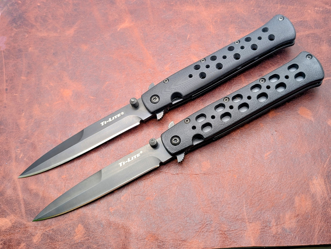

Don't want to make another thread on the Ti-Lite so just adding to this one.

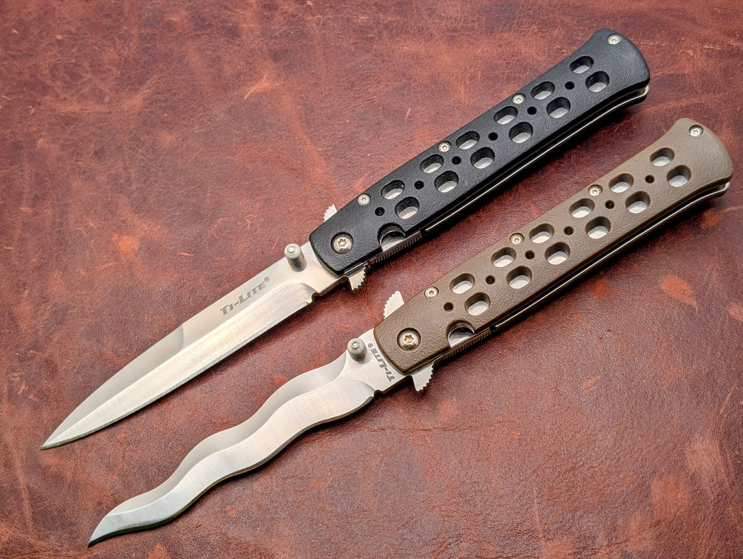

Recently picked up a bunch of the 4" versions. The 6" is a bit big for my EDC tastes, but it is still a bad ass knife - I did get one with the zy-ex handle.

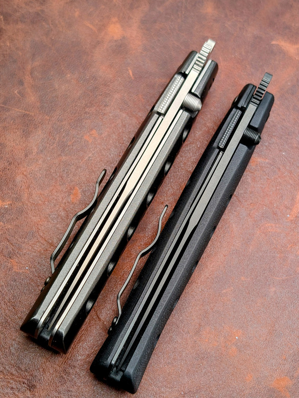

The zy-ex, aluminum and G-10 versions are significantly different for sure. I don't notice too much difference in action between the stone wash and black blades, but the aluminum with bead blast blade has the worst action by far. Both the black zy-ex and G-10 versions are basically the same.
The hole patterns are significantly different on each. Personally I like the look of the aluminum one the best.
The blades of the G-10 and zy-ex versions appear to have the same coating. Don't know if it's a true DLC or not. It doesn't appear to be as good as the real deal that is used on Spyderco or Pro-Tech. Reminds me more of the titanium nitride coatings that the original Lone Wolf knives used. Still, that type does have a molecular bond with the steel, making it significantly better than a baked on or Teflon coating. I was going to wipe one with acetone and see if it does anything but haven't gotten to it yet.
The G-10 version is a very different knife from the rest. Along with not having a mark side liner, the handle is also much more rounded, with thinner edges and a curvaceous contour near the butt end, whereas the aluminum and zy-ex handles are straight and chunkier. The G-10 feels awesome in hand!

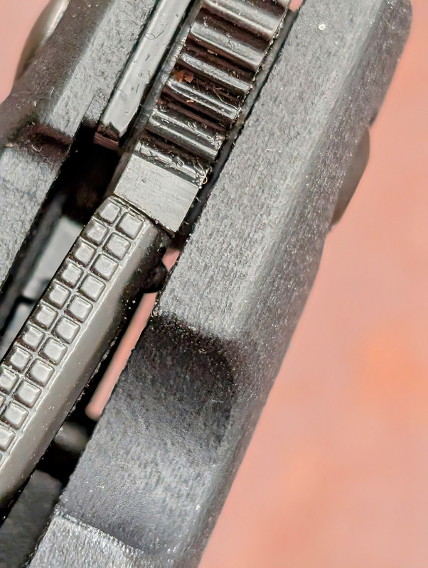

Another difference with the G-10 version is that there is a relief hole drilled into the inside of the handle to allow the detent ball space. I think K killgar suggested doing this once. The lock up is even later than the other versions. I handled two different G-10 versions and they both had very similar late lock up. It appears the detent ball is touching, but it isn't and the lock is solid with no movement.
At one time I probably would have worried about this, but after using another knife for years that had a very good steel liner lock which never changed position, it's a non-issue for me.
Also picked up a 4" kris. Has anyone actually tried using this one at all? Just wondering if it is good for much other than looking cool and stabbing stuff.
“Picked up a bunch”, lol
Nice comparison, btw. The Ti-lites are classic, but I find the sharp quillions are a real pain sometimes. Sometimes literally.
