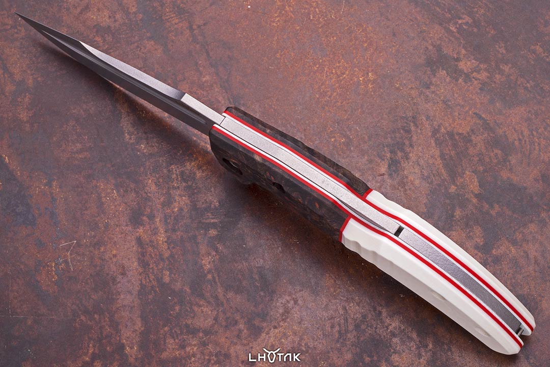

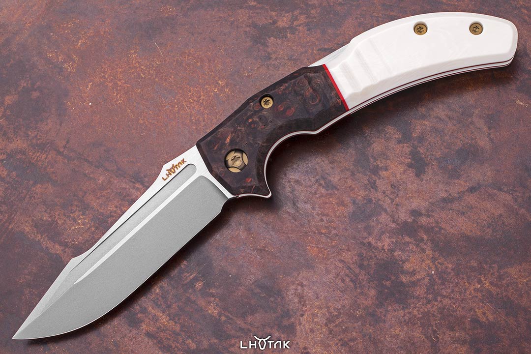

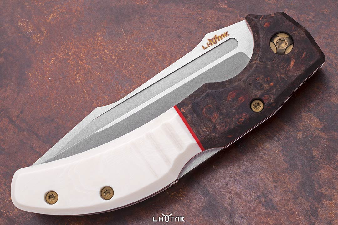

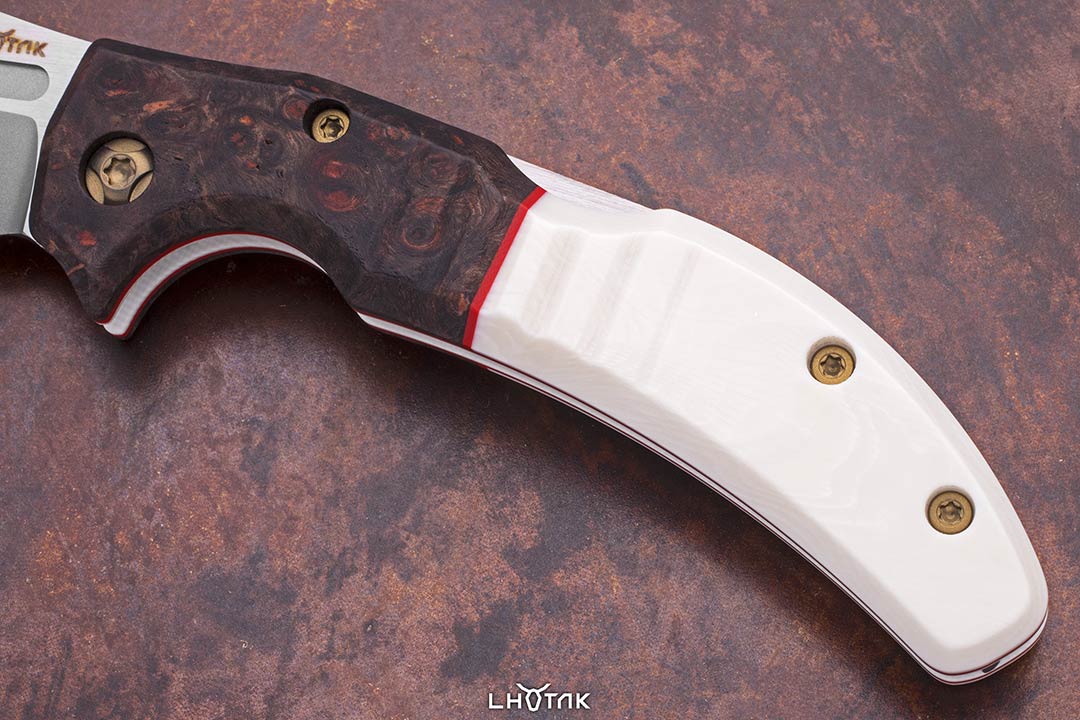

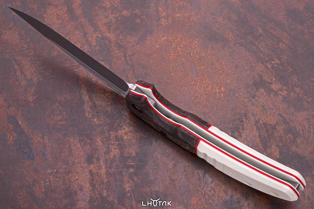

Hello,
just finished this Lockback. Blade is made from heat treated ATI425 Titanium. (HT was done by Mecha Mecha )
Screws, pivot barrels, lockbar, spacer, spring, stop pin and lanyard pin are made from 6AL4V.
Washer are phos. bronze, blade and the handle scales have a bronze bushing insert.
Handle is stab. Ambonia burl and Elforyn Super Tusk with G10 liner and spacer.
OAL is 7.8", blade is 3.4" and .118" thick. Weight is 2.25 oz.

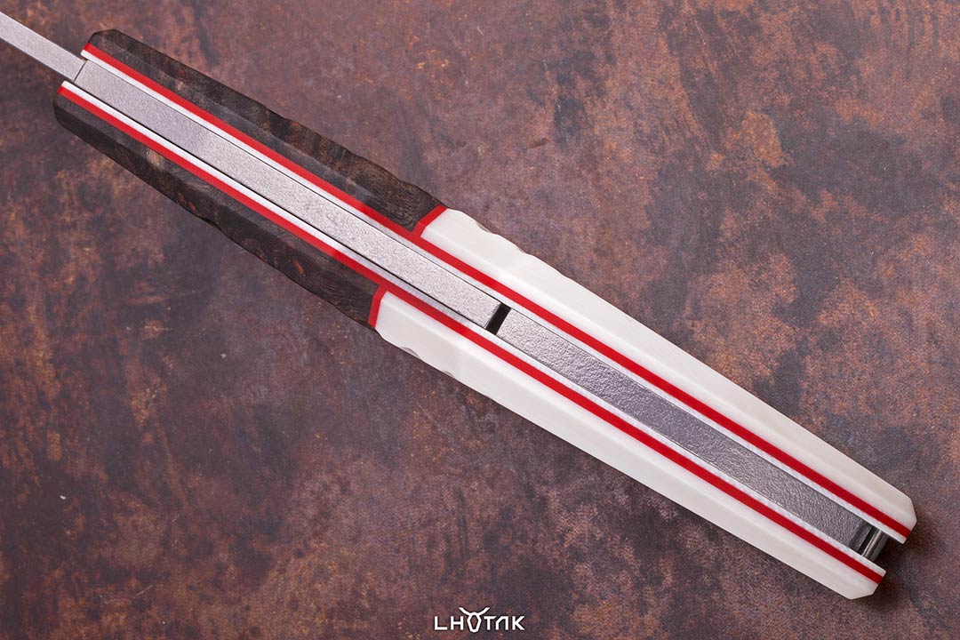

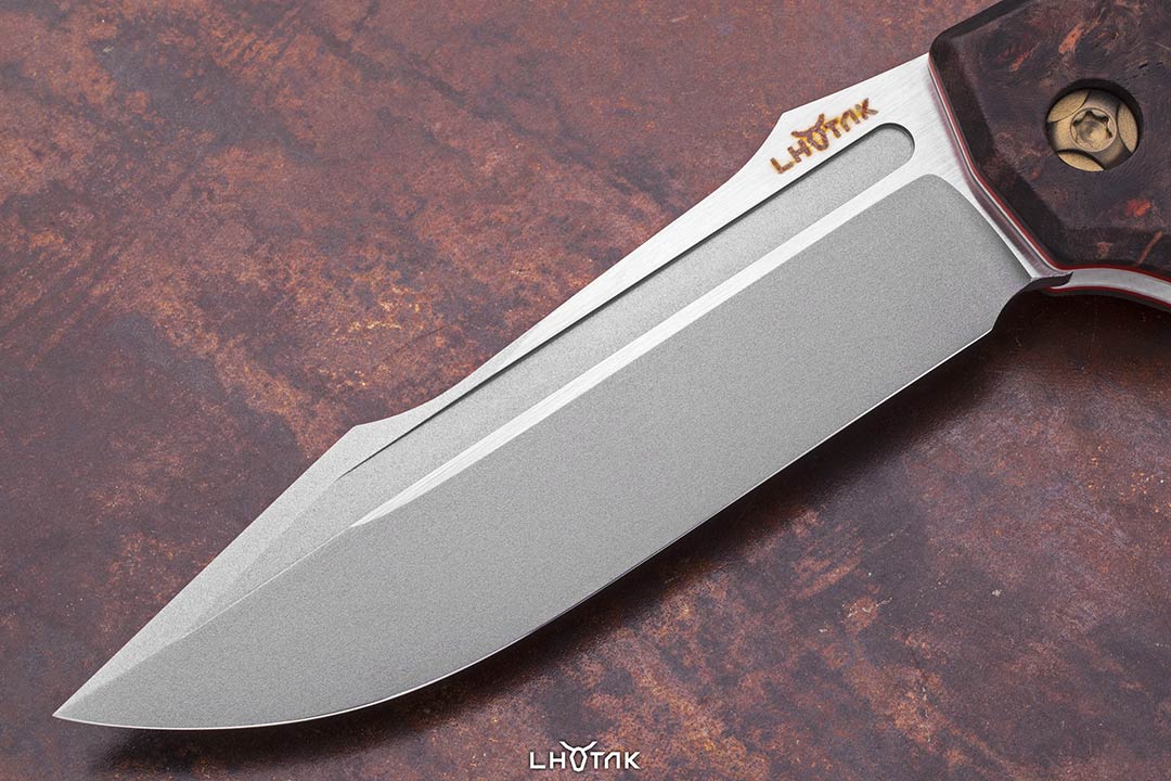

Fine work! I really like the fuller as a blade-pull. You should post that photo showing the inside, with the bronze inserts, it's a cool pic.

Beautiful! I've never heard of anyone using titanium as blade stock?
As for knives, i think i am the only one on this planet who makes knives from heat treated Titanium. :)
HRC is in the mid 50ies. They perform similar to a simple carbon steel blade like 1084 in terms of edge holding and ease of sharpening, but with a "springy" temper and of course no rust ever and super light compared to steel.

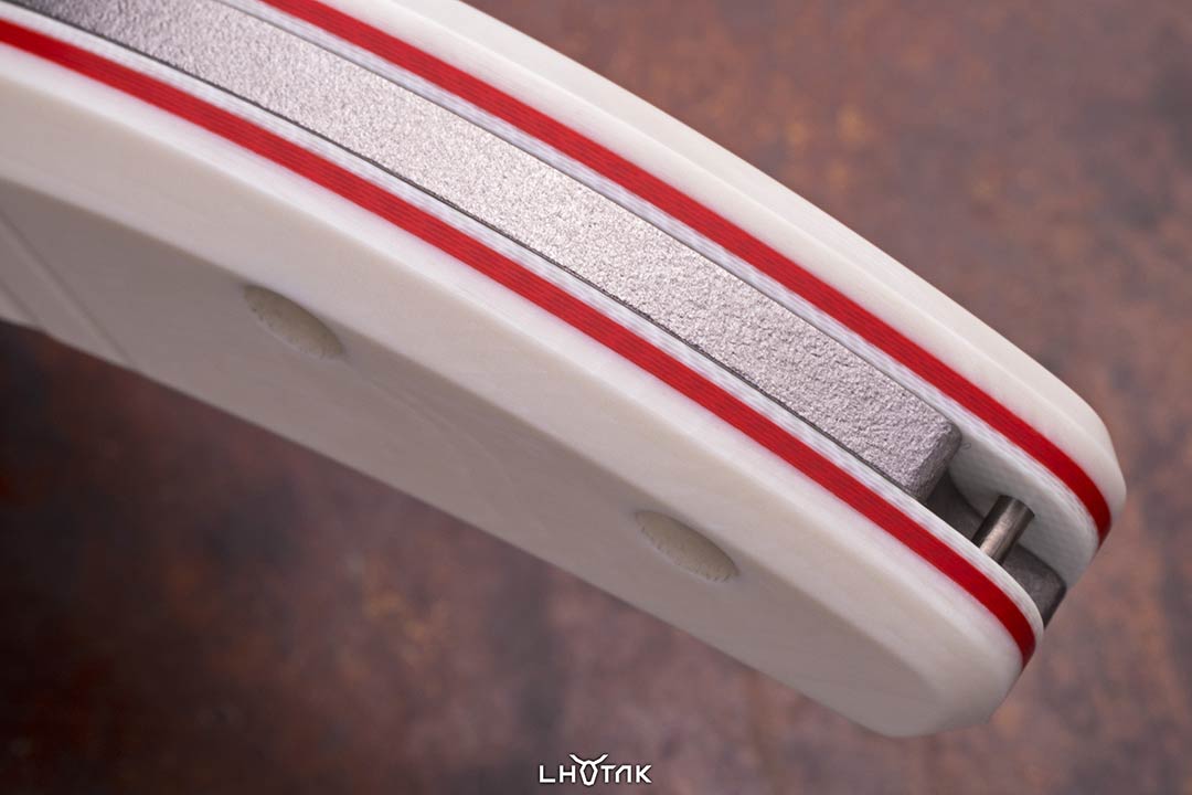

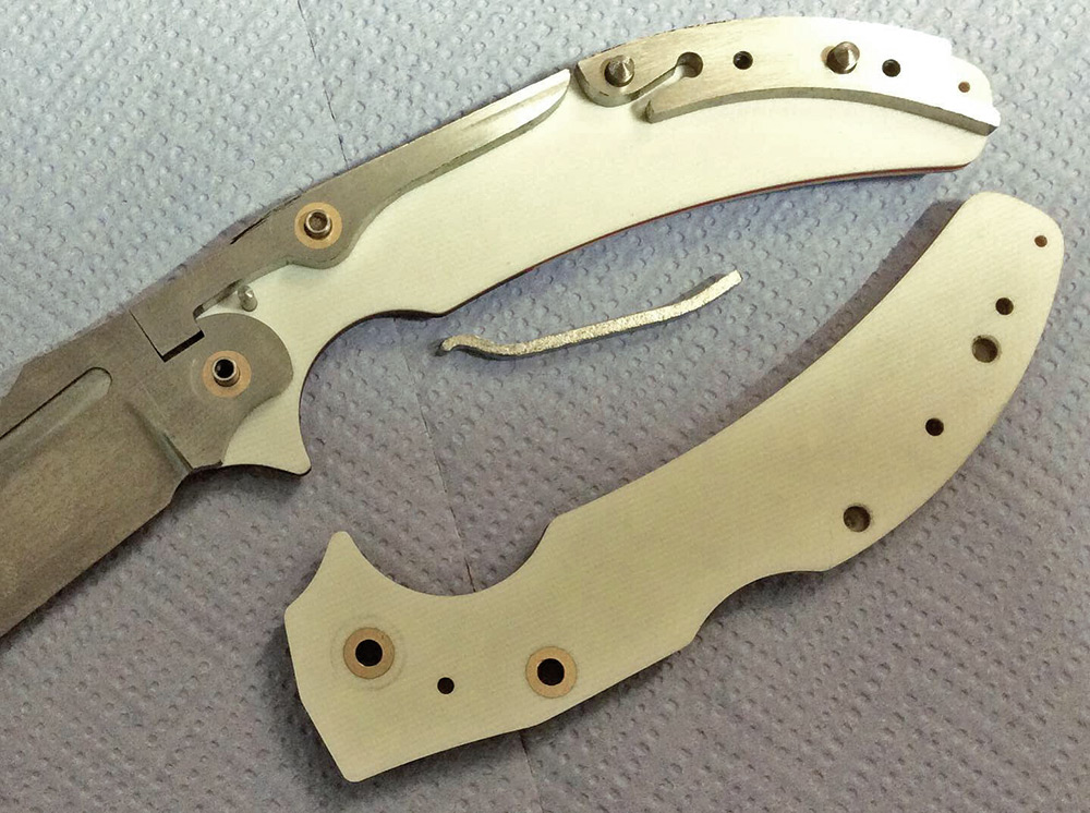

Anyhow, here is a dirty pic of the Lockback while still in progress of the "inside", showing the bronze insert and overall construction.
Ah yes you're right, totally forgot about Mission Knives. Guess i forgot about them because IMHO they went downhill since the new owners.
Awesome pic.
