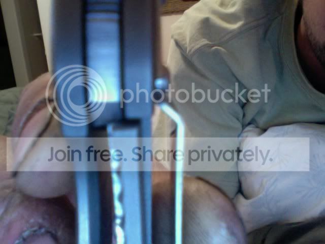

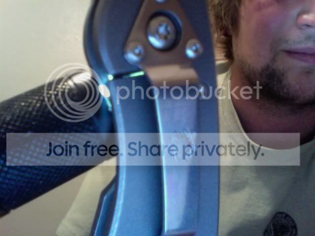

taken with my macbook sorta suck but you can see now... thanks
I don't think it is normal because only a nub of the stainless contacts... maybe bad tang grind?
That's normal. It's a difference in design philosophy. Some knives have the lock bar cut at an angle so that it only contacts the tang at the furthest point from the pivot, maximizing the benefits of leverage (and it's probably easier to make this way). If the lock bar contacts the tang along its entire width then you sometimes have potential for the side furthest from the pivot to wear faster and produce vertical blade play (the lock would have to contact almost directly underneath the pivot to do that, but you would be surprised how close to the pivot many locks are).
^^^Exactly. Beat me to it. It's nothing to worry about -- like Joshua J. says, it's designed to be that way and is perfectly normal.

Yeah, the rate of wear will be a bit higher due to the contact being spread over a smaller surface area, but honestly unless you're obsessively opening and closing your knife just for fun, it generally won't be an issue. Particularly for something like the Ti Millie with the hardened steel lockbar insert, wear should be even less of an issue.
Much better, improvisation always works in a pinch. That looks about normal to me, that lock ain't going anywhere.
Maybe, but remember that the contact on this one is now steel on steel rather than titanium on steel, and the insert is factory-replaceable if needed. :thumbup:

Absolutely normal. When I first got my ti millie, the lock up was considerably earlier than yours. When I say early, I mean just the width of the ss insert was making contact with the tang..it's at about 40% now
