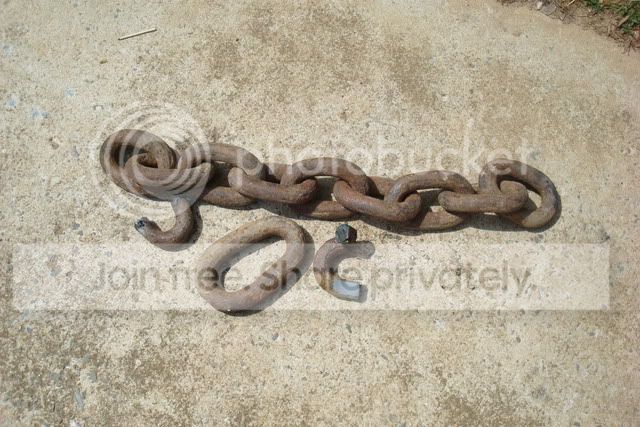

Thank you very much for the offer of wrought, but I think I'll have enough -
I happened to stumble upon this (literally, I tripped over the chain sitting in my way) at my local scrapyard, couldn't believe my luck, that stuff is 1" thick. Got it for like $0.49 per LB. Don't know what I'll do when that runs out though, have to pay real prices for it I guess.
