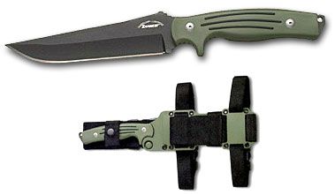

The local B&M store just got this fixed blade in today. I got to handle it and it's pretty sweet. It's an OD green sheath with OD green handle and black blade. The sheath is huge and is meant to be attached to a belt and then strapped to your thigh. What's weird is that the sheath seems to be somewhat left handed. If you wear it on your right side the sheath is flat on the outside but rounded against your leg: doesn't really seem to make sense. Maybe I was rigging it wrong. Anyway, it's cool and I'll probably buy it in the near future.

Callahwj is right. This is what it looks like:
Although knifecenter says it's rigged for shoulder carry, the sheath has what appear to be leg straps.

I really don't see how it could be rigged for shoulder carry: I think KnifeCenter might have gotten the wrong info. If I am correct and it is for thigh carry then it can't go edge forward because of the button release you see on the sheath and the side that the belt strap is attached to: see in the pic what I'm saying?
The sheath didn't really feel like kydex (felt cheaper) but I aint a sheathmaker so I could be dead wrong. It's a cool and intimidating sheath but I don't see it as practical. I would love to strap it on and mosey around but that would be for the badass factor.

The sheath claims to be Kydex, but it does not look or feel like the Kydex I use or get on other knife sheaths.:confused:
It also takes a bit of practice at un-sheathing the beast. You have to fully depress the button located under the sub-hilt before pulling the blade free. It sounds easy, but it took me quite a few tries before getting consistently good withdrawals. The sheath does not work really well without tying it to your leg either.
The edge:rolleyes: was soooo highly polished, it would not cut or even shave hair. They polished the edge right off. After re-establishing the edge on a ceramic stone, it was scary sharp but the thickness of the edge still is not what I would consider "high performance". Too bloody thick. Don't even think about using a Sharpmaker on this edge. The edge angle is 25+ degrees.
The knife is basically a stainless steel sharpened pry bar.
The good thing about it though is the handle. It's fairly comfortable. You can choke up on the handle and get a sub-hilt advantage out of the handle. Move your grip behind the sub-hilt and you still have a handful of handle with more leverage for chopping and the sub-hilt becomes the main guard. Pretty cool.:cool: Please refer heavily to the pic that el cid provided to see what I'm babbling about.:o

An hour of messing and tinkering and I still couldn't get it rigged to suit my needs. The only way to make this thing work is to strap it to your leg like a freakin colostomy bag.:barf: I have thick thighs, so this was not even possible for me because the nylon strapping supplied is obviously meant for stick legged soldier types.:mad: GEEZ!

I got one of these a couple of months ago from Knifecenter. I initially bought it for the "cool" factor. I haven't actually "done" much with it yet but I love this knife. When I'm "outdoorsing" I am highly active so I really appreciate the security that the sheath allows. I was also puzzled about the "flat" side of the sheath but didn't spend a lot of time worrying about it. The sheath does not have to be used as intended out of the box. A lot of the "bells & whistles" can be easily removed and even turned around so the sheath is "lefty friendly" (the button can be released by the thumb or the index finger). The sheath can be made "simple" if a little time is afforded. It does not feel like kydex but rather closer to the "secure-ex" that Cold Steel uses in some of their sheaths. It also has lashing holes for paracord or whatever. Not a bad venture at all and probably my favorite sheath of all my knives. The leg straps are pretty short... I'm only 175 lbs. and they are tight on my legs. I could see where this would be a problem for bigger guys.
As far as the knife goes, it is pretty thick, though mine popped hairs right out of the box. I really appreciate "the no-frills" construction and the durability of the coating and handle(as was stated above would be a great diving knife). I am a fan of big, heavy duty knives and this one is a good one. It would also make a terrific fighter. Like I said, I haven't done much with it but when I do I will definitely post some feedback. I just saw all the negative stuff about it and decided I would post some counter thoughts. If you want a good heavy-duty, multi-purpose outdoor/utility knife with a good multi-optional sheath, this is the one for you.

I just got a TImberline Zambezi and it is quite a beast. I did search on the forum and found this post about them. I have to agree that the knife is very sturdy and the sheath is definately "Bomb proof"!
It took me a bit to figure out how to lengthen the belt loop to drop the sheath low enough to allow me to attach the straps around my thigh. It does look as if the sheath is backwards as the curved portion is against my leg and the flat side is facing out. That large SR-50 buckle on the belt loop is big enough to tow a Jeep with!
I would have no problem rappeling out of a helicopter, jumping out of an airplane or diving with the knife in this sheath, but I think it is a bit too much for wearing when I am on my ATV's or just hiking in the outback. I think I will be in the market for a simpler Kydex sheath for my belt for this blade.
