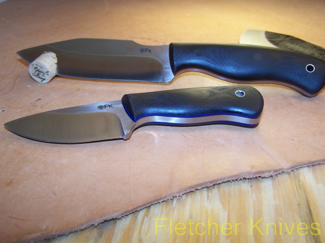

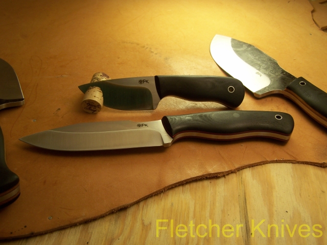

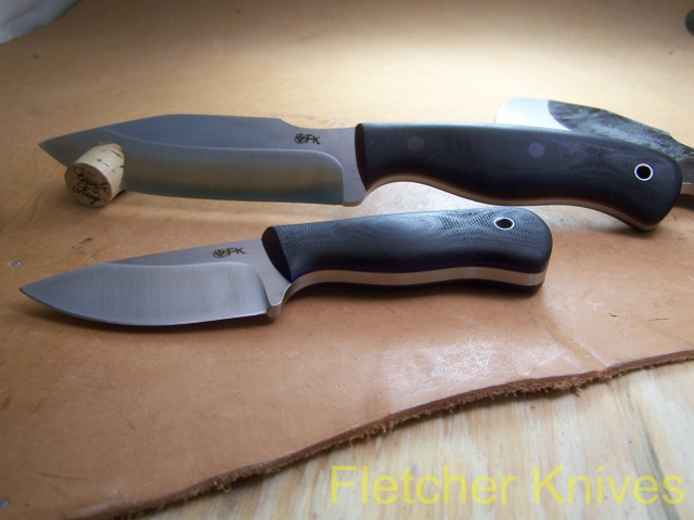

Andy and I did some stuff in 440C the other day. Here are mine all finished up.
They are:
Kilo, done in 3/16" 440C convex saber ground with double black canvas micarta, black and blue liners, and G10 1/4" pin and stainless 1/4" tube.
niiiiice. :cool:

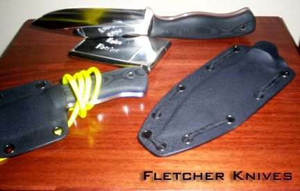

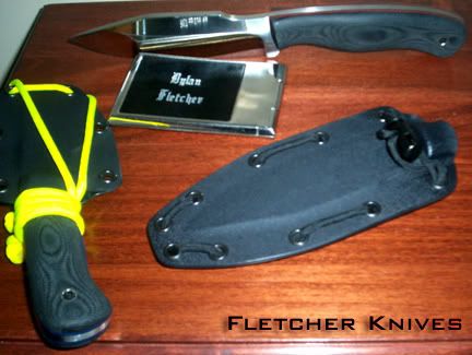

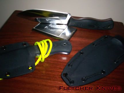

The other is the new version of the Delta Foxtrot. I have yet to come up with a name. Right now it's just the Delta 2.0. I jokingly refer to it as the Charlie Foxtrot. It is 3/16" thick 440C convex saber ground with mirror polished flats, double black canvas micarta, black and red liners, two G10 1/4" pins and one stainless 1/4" tube.
Both of them got some really sick looking kydex.
Be expecting a lot more stainless knives from Fletcher knives. Also, be expecting exotic stainless. :D
