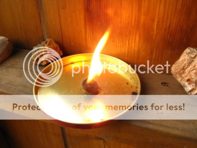

I made up some little tinder balls using candle wax and sawdust. They look like deer poop. I did a little test to see how well they burned.

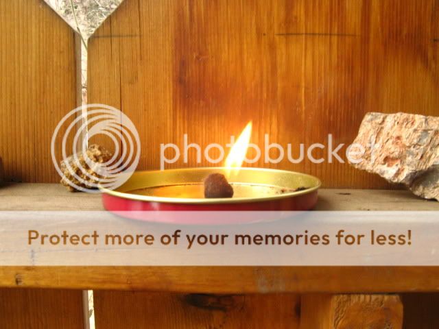

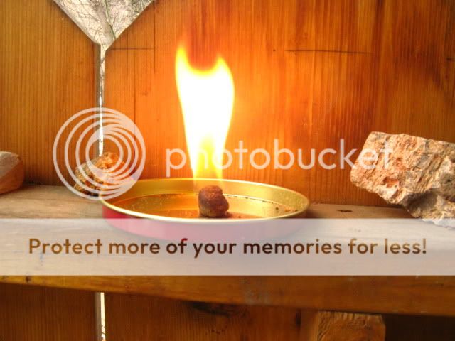

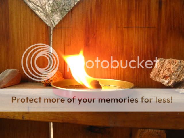

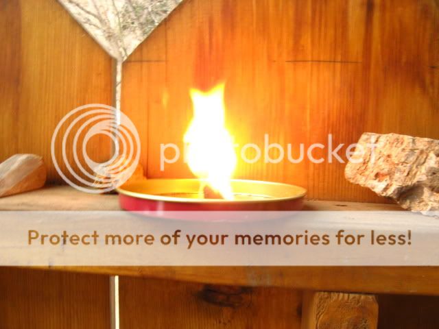

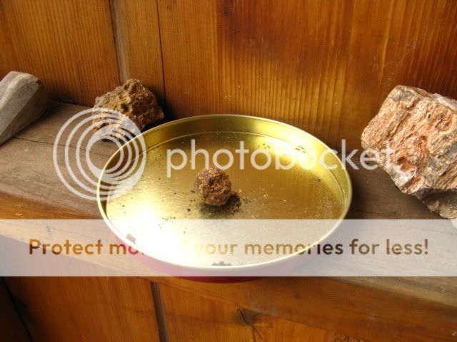

They take a little while to get going, about 15 seconds of direct flame. They reach full burn at about a minute and a half. Peak burn lasts about 2 minutes. At about 4 minutes they start to go out but you can blow the remaining coals for about a minute and a half.

The downside was that they were hard to light. It was windy out today and they would blow out before they got fully burning. Once they got going I had a good 2 minutes where the wind wouldn't knock it out. Probably not the best for starting a fire initially, but good for producing a lasting flame that will ignite kindling. I packed up a bunch in an old chewing tobacco pin and added some extra sawdust for cushion. Then sealed the tin with electrical tape.
